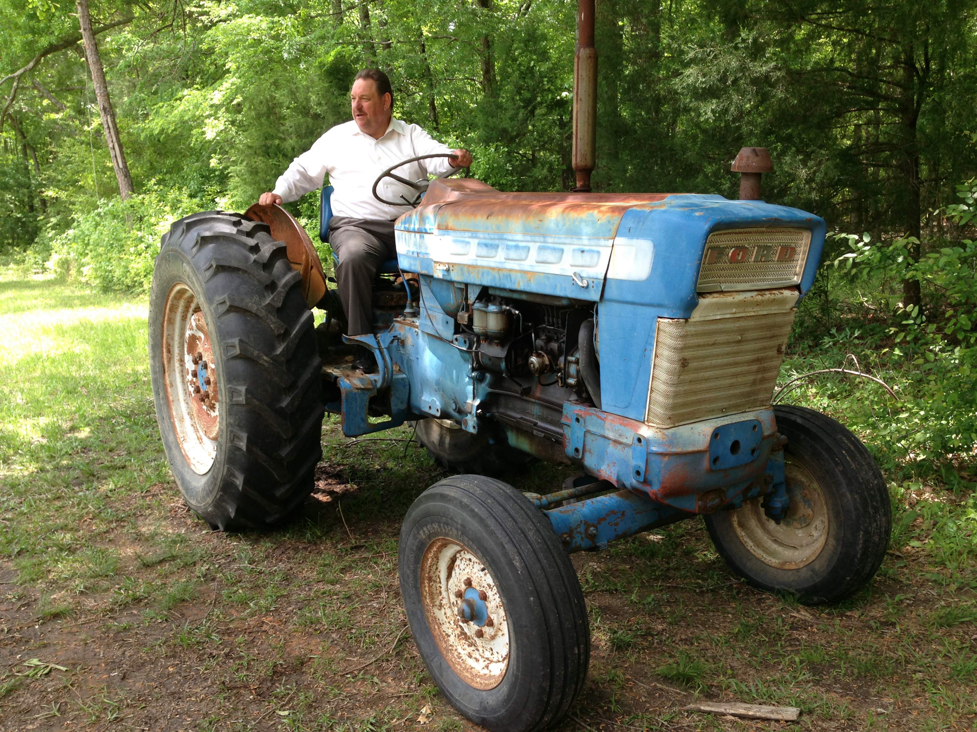

photo.jpgPlease help. I've been working for four hours to identify exactly what tractor I bought.
This is what I know:
hi/low range, 8-speeds
These are the numbers behind the starter:
B-071591-7F9
R282961
I'll post some pictures in a minute.
Thank you in advance.
Tony

that looks tobe either a 4000 or a 5000.but im pretty sure its a 4000.an if so its a 52 to 55hp tractor.
   / CityBoy desperately trying to ID his new/old Ford tractor #3
post some of the usefull numbers off the bellhousing flat that is on the same side as the starter.
ps.. 5000 are 4 cyl. 4000 are 3 cyl.
i see 4 lines on the simms injector pump.
i also see the olderlouvered
68 and back tin.
if the block has screw in core plugs vs regular knock outs.. it is a 233ci engine.. and near the lower hp quoted. if it has the knock out plugs.. it's a 256ci engine and 70hp.
nice looking.
i LOVE my 5000
