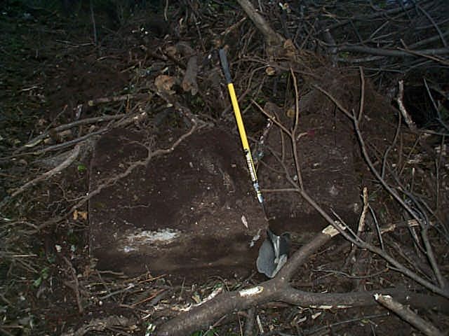

Here's what I've found out. There was an old sawmill on my property about 40 years ago. The only thing left of it was about 16 concrete pads that are about 3 feet square and from 8-14 inches thick. We had removed 12 of them that were in the backyard when we bought the house 2 years ago, they are real hard on lawnmower blades. The other 4 we didn't know about because they were in an area that were overgrown with weeds and sumacs. We piled the brush we had cut up 2 years ago on top of them. When I went to push the piles back the other day I ran over them. The soil has a lot of composted material in it so the tractor sank in as it was pushing forward and I ended up bending a couple of the rods underneath, left rear brake and the one that goes between the front tires. The dealer said I also bent up a filter that was under there and there's a leak. I had to take my wife to the hosptial yesterday for some pre-surgery tests so I wasn't here when the dealer came to pick it up. I will have to call him this morning to find out what needs to be done. He had told my son that he would contact Kioti to see if any of this would be covered under the warranty but I'm not holding my breath!! I'll take some pics of the blocks once it gets light here and post them. Nice to know it was "operator error" and not a problem with the tractor.

I am attaching a pic of two of the concrete pads I moved. I believe the one on the left is the one that gave me problems. I put a shovel between the two of them so there would be some way to gauge the size.
