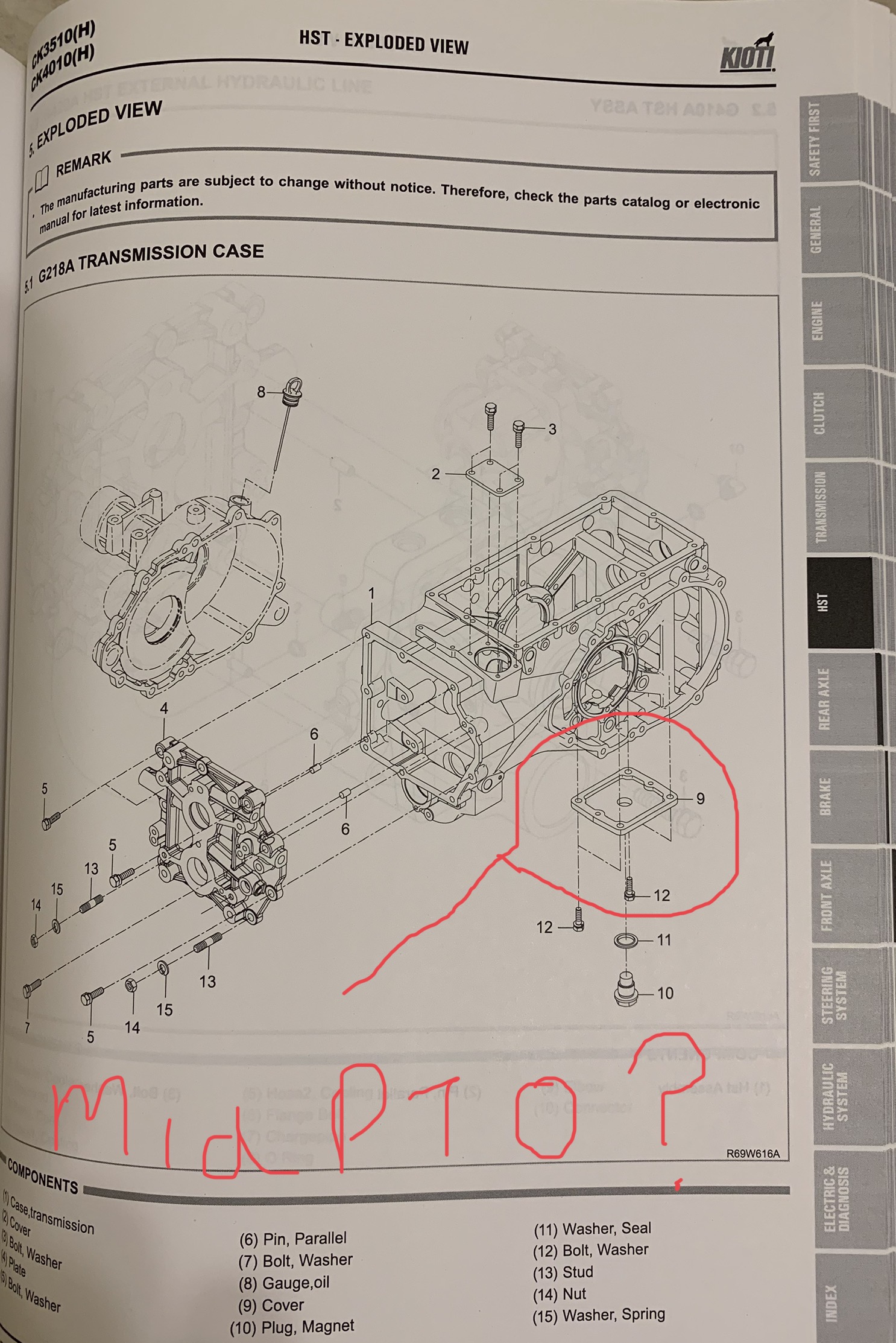

Im thinking of going the front snowblower with Mid PTO but I’ve heard you loose some ground clearance. Ive searched the full service manual and couldnt find anything on the Mid PTO.
With that said my wife accuses me of being blind! :laughing:
Anyone have a picture of the Mid PTO and its location?
Edit, this is the only place I can find for the mid pto, right between the two rear tires...
See picture

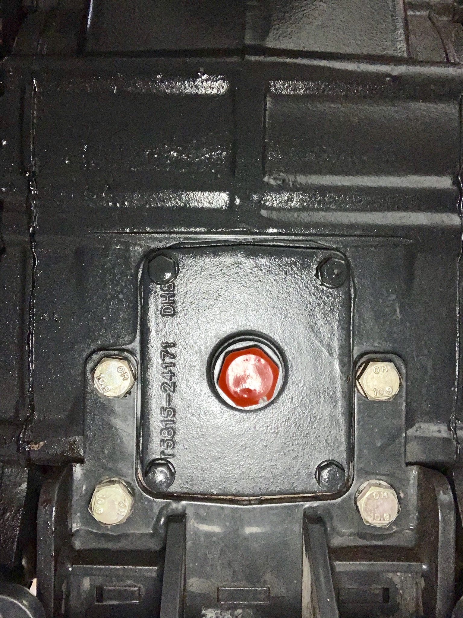

Couple more pictures. My concern is dealer says..
“Please Note: - The Snowblower Subframe Mounts and the KIOTI Backhoe Subframe Mounts cannot be on the tractor at the same time.”
I can only surmise that the backhoe brackets need to be removed because the snowblower subframe brackets bolt up in the same location.

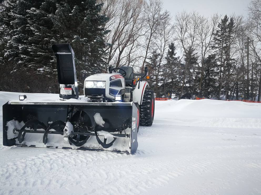

At least on the Bobcat version of the CK35 the Backhoe subframe crossmember will hit the mid PTO driveline if both are installed at once. However no removal of anything associated with the backhoe subframe receiving mounts is required. The front mount snoblower is easy to mount. Half an hour with practice.

I think the Bobcat version must be different. The quote in my previous post was from the dealer.

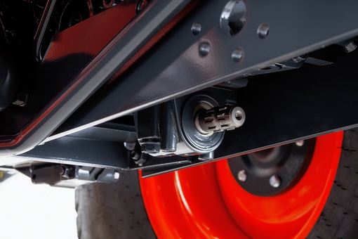

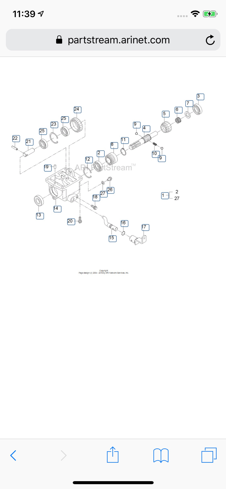

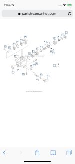

Only images I could find with the mid kit. *

Not positive that was on Messicks and came up when I search the CK3510
I crawled under it and it’s not it. CK3510 doesn’t have a frame but the backhoe has a subframe.
I bet the mid pto is accurate though.
