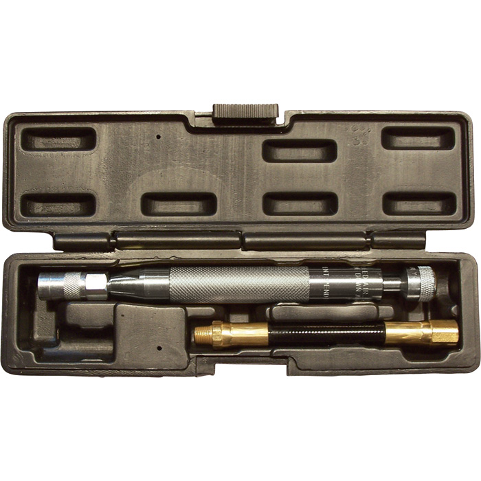

   / CK front axle pivot grease #9
You can try this tool before you take it apart it might free it up. grease fitting cleaner 403100_700x700.jpg
   / CK front axle pivot grease #10
My axle, when suspended
does not pivot easily. If I stand on the wheel, it moves.
It shouldn't rotate easily if adjusted correctly but you shouldn't have to stand on it. I move mine with my hand with the tractor front lifted for greasing. The rear zerk always takes grease easier than the front zerk. My CK30hst is the same age and hours. Usually grease everything Spring and Fall and after a big job. So far so good and never seen one apart. Maybe check the zerk fitting first if you haven't already and hope that's the problem.
