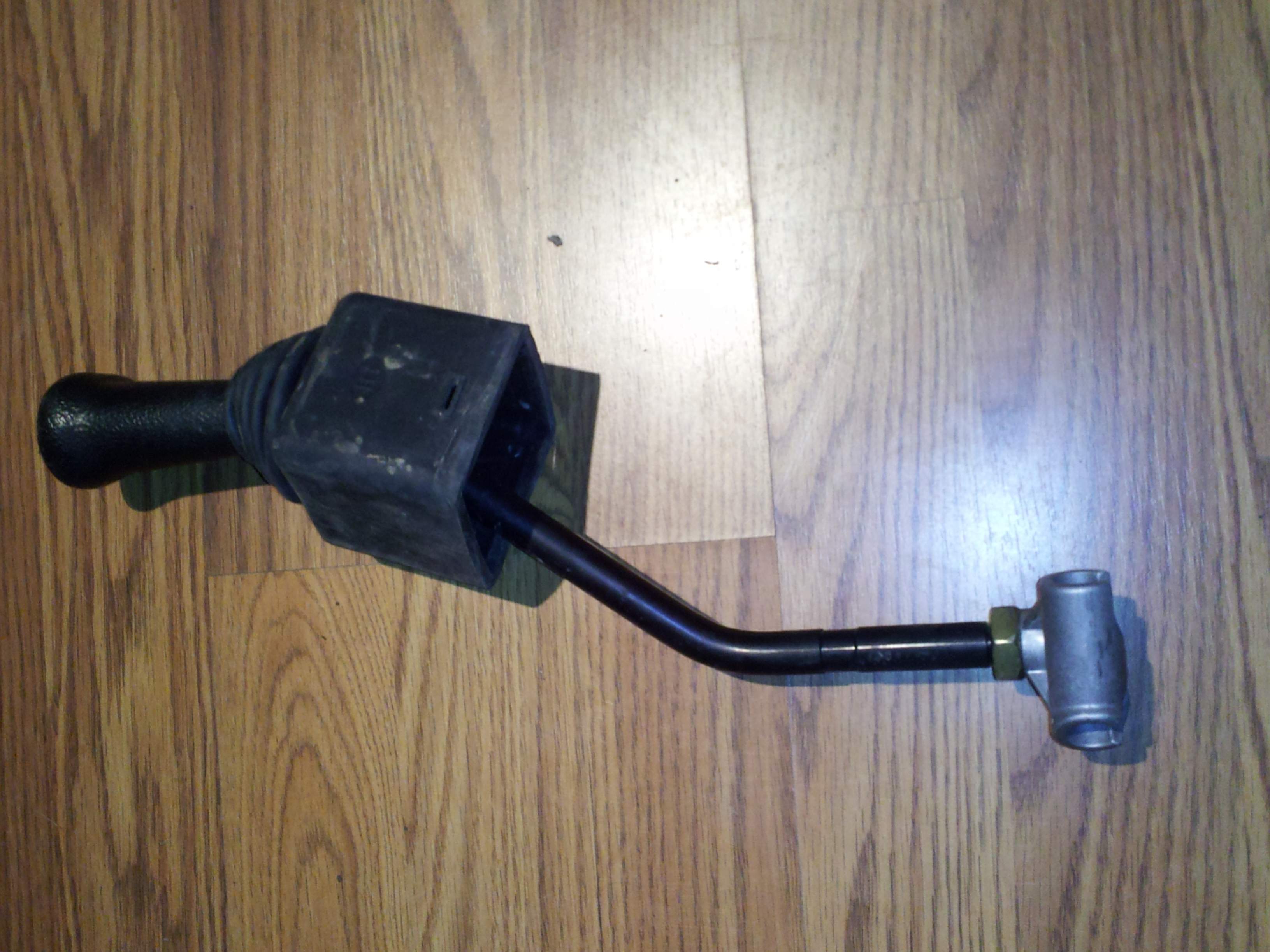

Getting just the joystick lever out is not a big problem if you can get the bottom of the boot loose. Lift it up loosen the jam nut and unscrew lever from the pivot base.
This is and extra joystick I have. Plans I have for it, a straight lever might work better so if anyone wants to trade PM me.

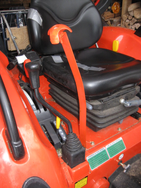

heres a simple solution to getting off on the right side and safely backing up. Add a bar by fastening it to an existing bolt between your knee and the joy stick. I nearly took my head off backing up with a lift of 2x4's and not realizing my knee was raising the fel. Looked up just in time!!ck35 017.jpg
   / CK series loader control. Has anyone modified it? #7
Hey Delgra...black Gorillia tape matched the seat much better...ask me how I know?:laughing: Never get in the seat with a 8" screw driver in your back pocket :cool:
