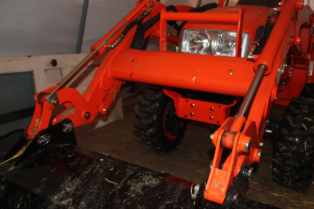

on my kubota the torque tube is round and hollow right behind the quick attach on the loader arms

Is the torque tube (the connecting piece about three feet behind the bucket that holds the left and right side of the loader together) round and hollow or is it a closed box? Almost certainly you have the round tube version as the original version has not been manufactured for about five years now.
Thanks - looks like I'm good. On the actual sticker on the loader it says it's a KL120P.
It's round and hollow but also has a cover.

Pics as promised.
Old style (2006-2008) This has a rear access panel bolted on.
back view
front view
side view

New style or 2011 model. This has a wrap around cover front to back.
back
front
side
Hope this helps.

I see grease coming out of those joints. Was that only after you got the tractor? Are the bushings also in need of replacement? That would seem to be a much bigger job than just repacking the cylinders.
