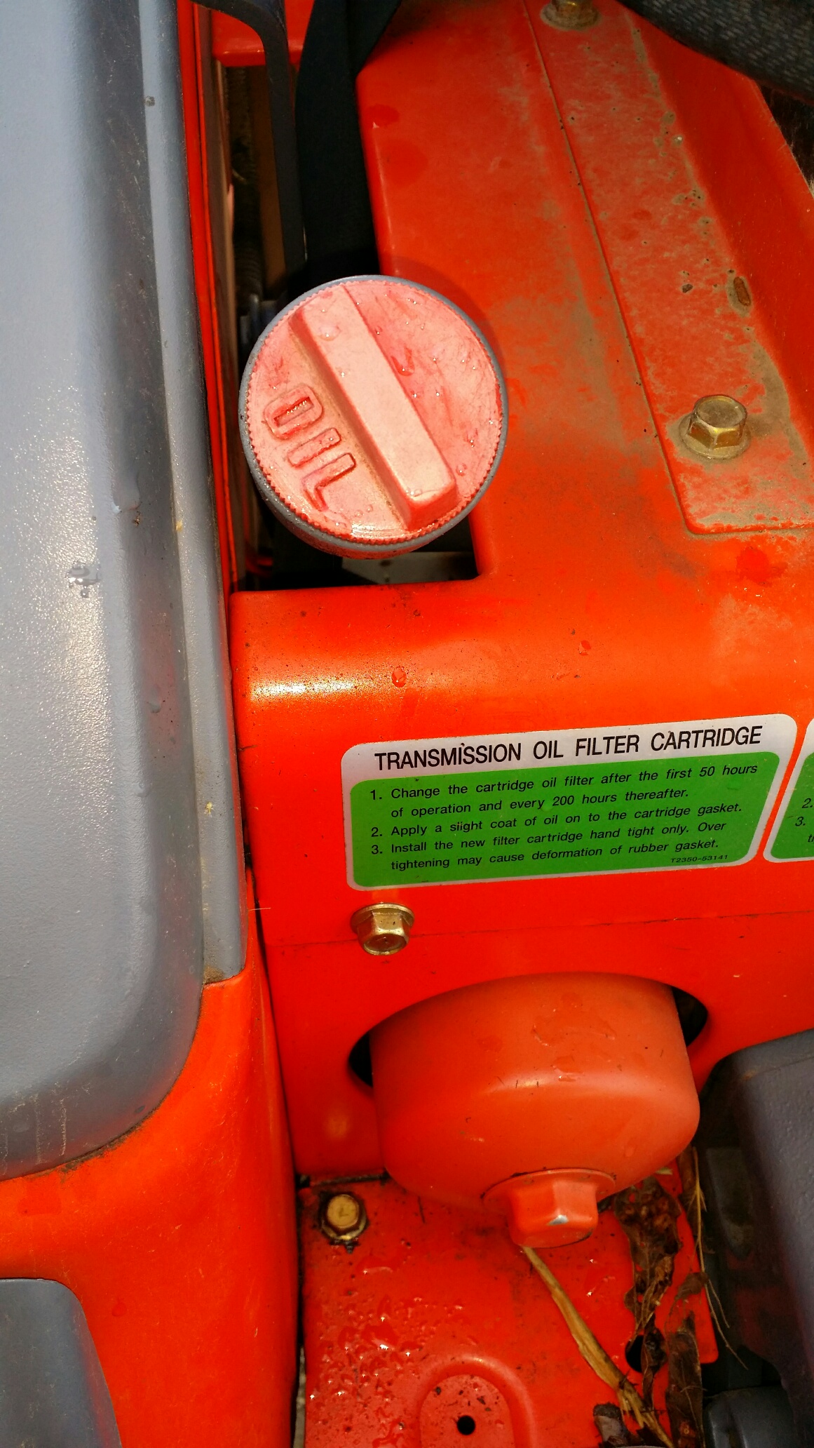

I don't seem to have anything but a simple cap. Attached a pic.
   / CK20 HST Hydraulic Fluid squirting out dipstick #5

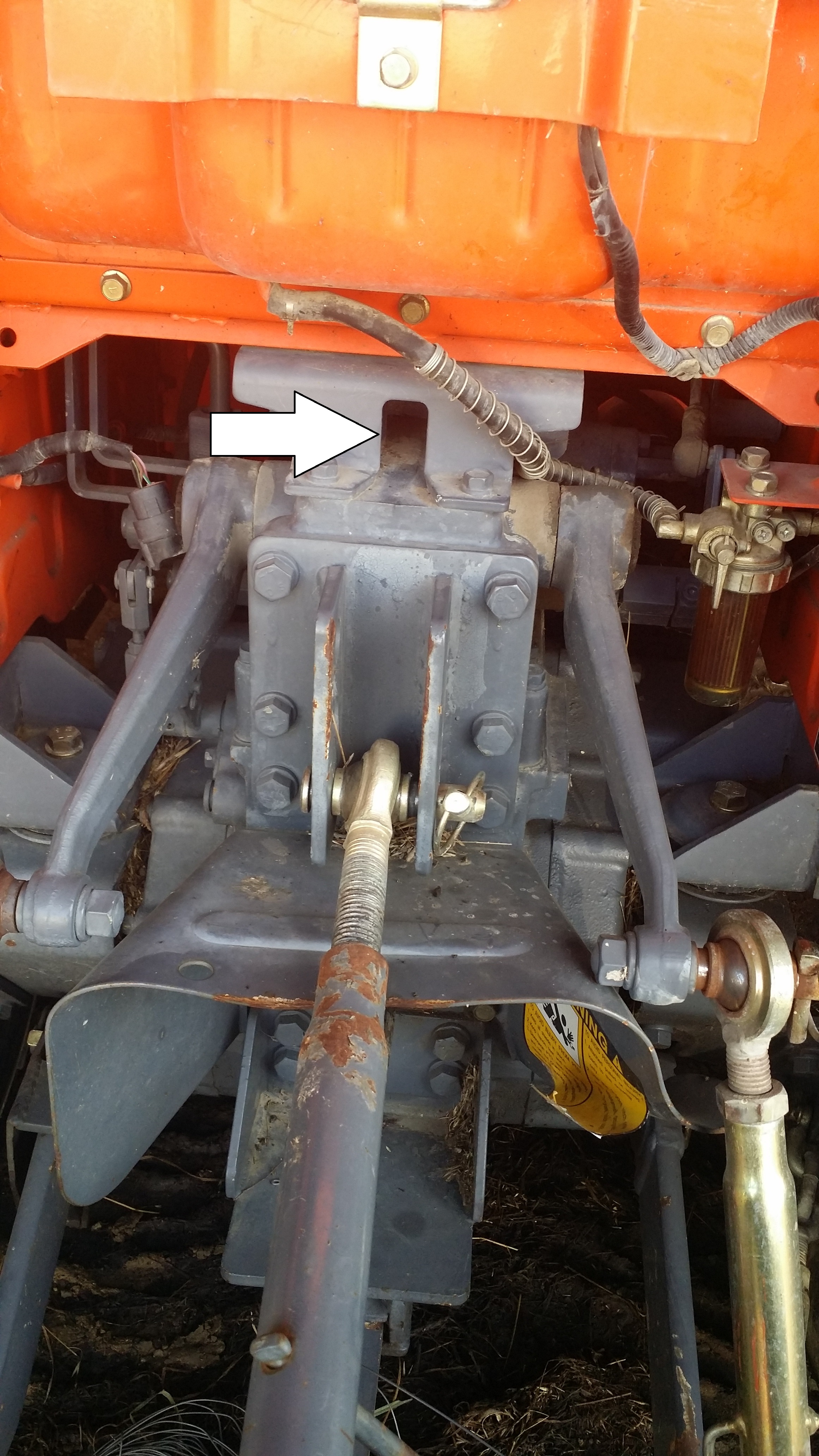

Go to the back of the tractor and look under the seat and there you will see an upside down J hook which is the breather. Clean it out and you should be just fine. Your tractor does not have the breather in the fill cap like most Kioti tractors do.

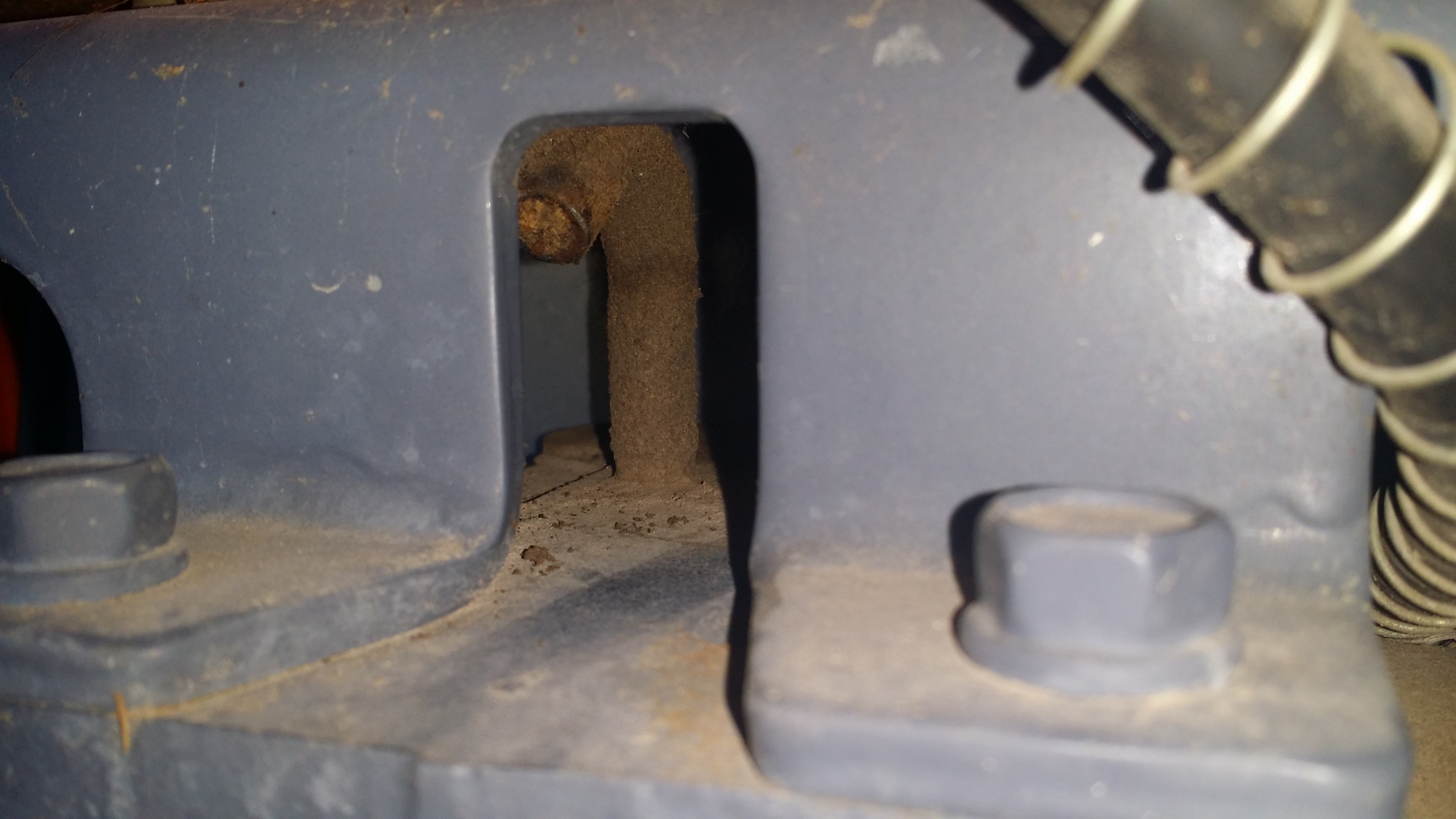

I know it has been a while.... 3 years but I ran across so pics I had of where the J hook vent is on the CK20H. I was a little bit of a dufas and could not find it when looking under the seat of my tractor. I took off the seat and the housing and could not find anything that looked like a J. Well a little while later I stumbled across the parts diagrams for the CK20 and found an image of the hydraulic cylinder body showing the J vent. I know it was a "forest for the trees" thing but just to provide additional help to anyone who has the same problem I want to add these pics. Mine was actually more under the gas tank than under the seat. Cleaned it out and have not hand any problem since then.Pic1.jpgPic2.jpg
