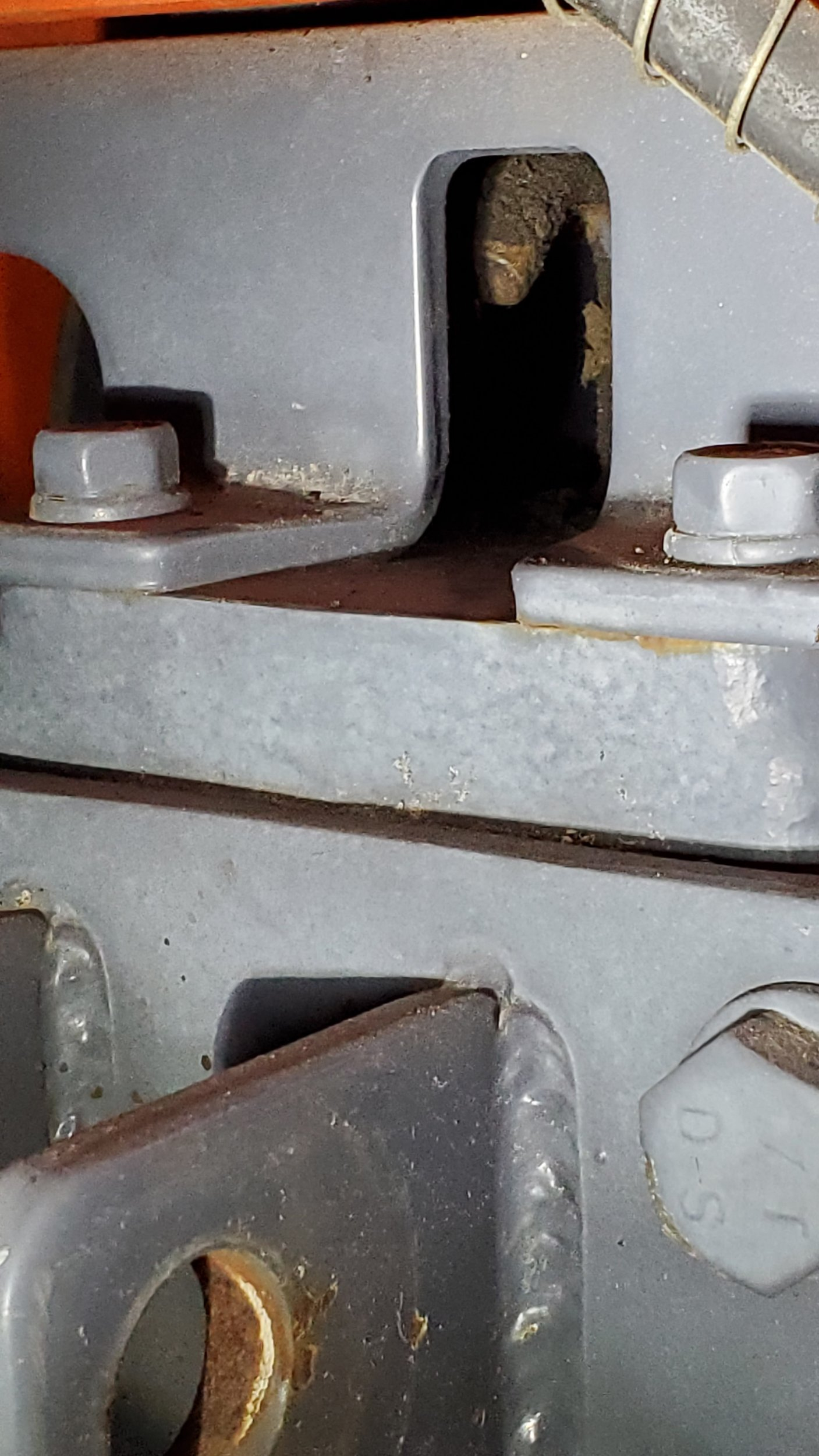

Freaking mud dobbers! My Kioti CK 20 HST with 328 hours started overflowing the hydraulic fluid out of the dipstick tube. When I take the cap off the fill tube I could hear the air pressure relieve. There is a little upside down candy cane vent under the seat that can be seen from the rear of the tractor, the blessed mud dobbers stopped mine up.
