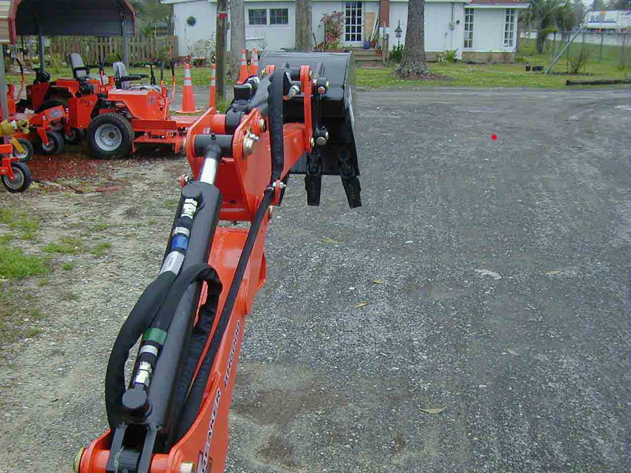

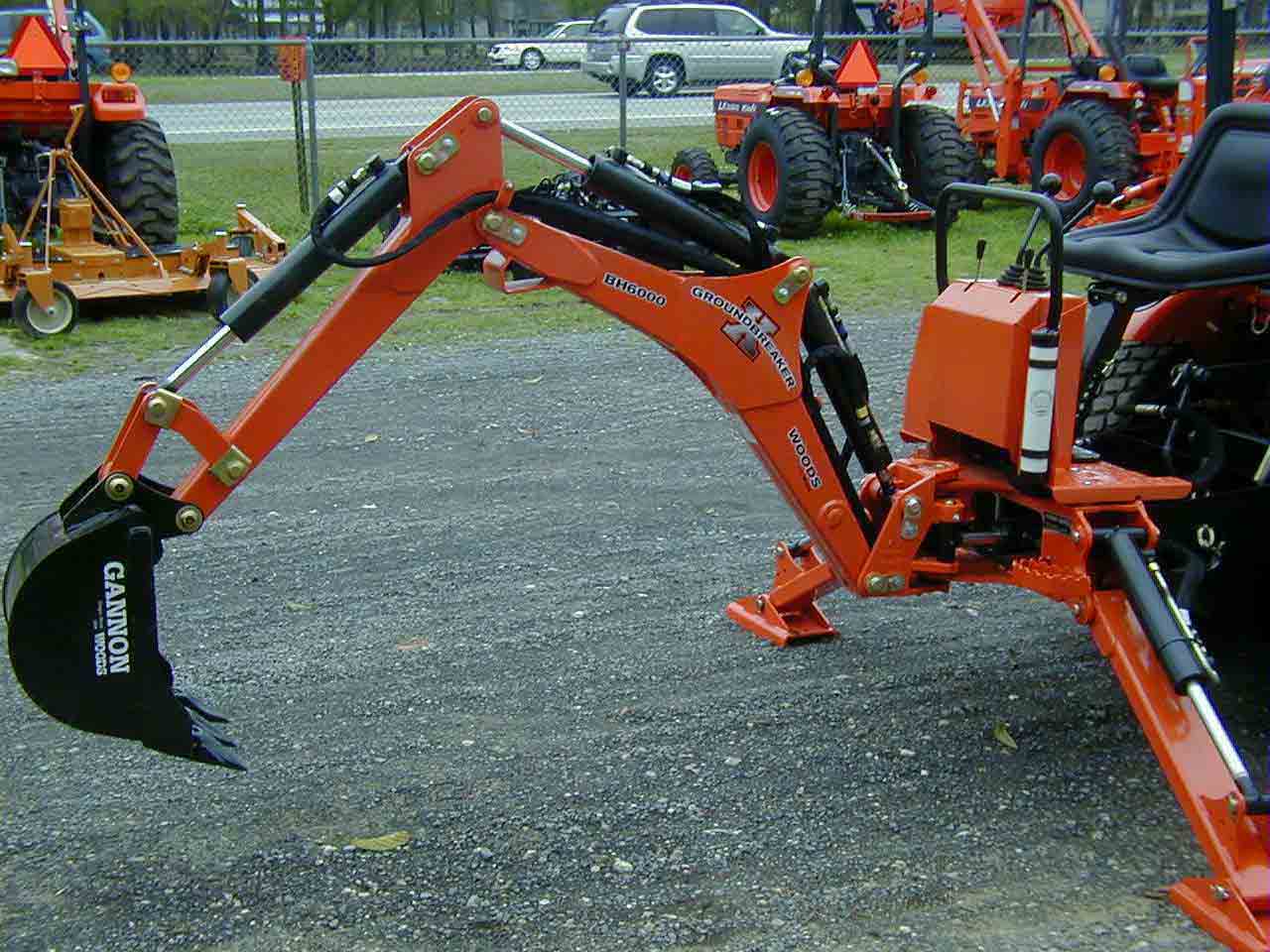

Here are the pics of the Woods BH6000 mounted on Kioti CK20. Also has the Woods loader.
The backhoe controls are very smooooth and substantial feeling in your hands. The stabilizers don't bang on the hoses when you raise them back up. The new curved dipper stick is the coming Woods design for all the BHs and appears to be very strong.
The subframe sits in two fork hooks at the bottom, and has two bolts at the top and the frame goes up to connec to the Woods loader frame. This subframe sits much higher than the Kioti model, and maintains a higher clearance. Also allows for use of a Mid Mount Mower (MMM) while the BH is on. Can't do that with the KB2375.
I liked this loader a lot. There are 10 pics altogether, and the final one is of the final checkup on the CK20 dressed in Woods. John
