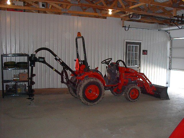

Here's my PHD set-up. Gerard

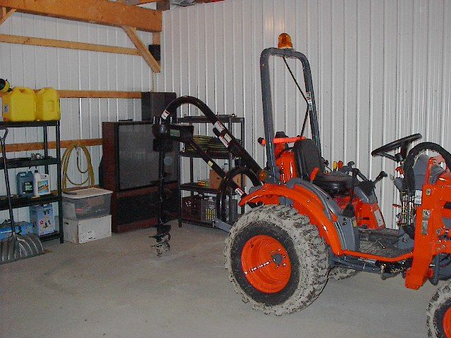

One more view. It works great. Gerard

Thanks for the pictures GerardC! you'v got all the toys eh I mean professional grade equipment
