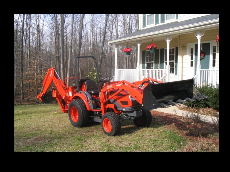

Hey John,
Mine was thrown in with the deal, so I don't know the cost. Anyway I got the 54" toothbar from
CarverEquipment , I have seen several people posting about their purchase of the toothbar from Carver and all were positive. It does make a big difference, especially when you forget it is down and move forward/backward on your nice lawn. /forums/images/graemlins/blush.gif /forums/images/graemlins/crazy.gif /forums/images/graemlins/blush.gif
