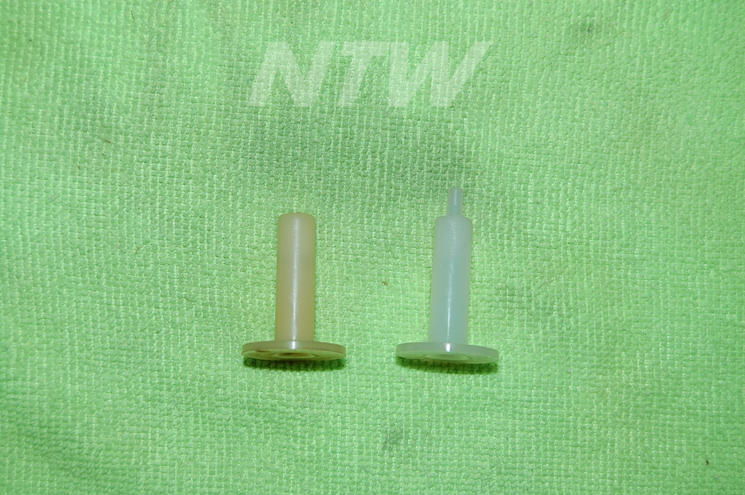

DSC_0276.JPGHere's the possible problem as this happened with my CK30. Pull the solenoid, "fish" the engine stop solenoid guide out.......be careful as it can drop into the gear case (I pulled the "speed control plate" off which made it a lot easier to ensure it didn't drop). The guide should look like the one on right (see photo). If it looks like the one on the left, then this is your problem. The part number is: E5850-56603

DirtHauler's solution also applies to the new version of the stop solenoid. The new and old versions work exactly opposite: the old version gets power (for about 8 sec) to stop the engine and the new version requires continuous hold power (after the 1-sec pull pulse) to allow the engine to run. Kioti changed different models to the new version at different times between 2005 and 2008. I thought 2007 CK20 models had the old version, but I can't be sure. Until the OP tells us what version he has we are spinning our wheels.
