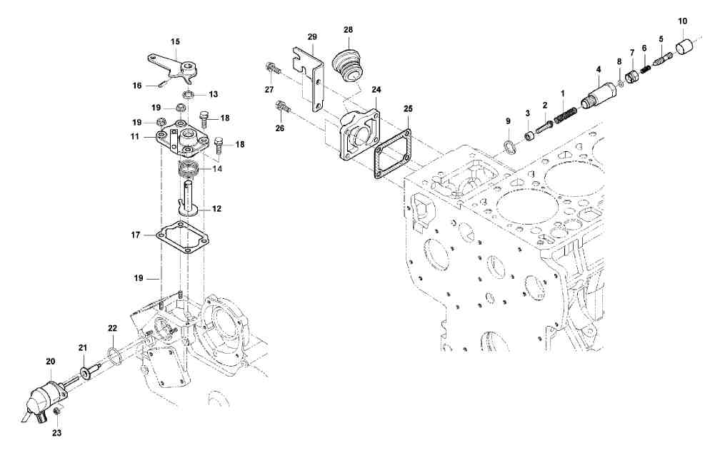

Sounds like the fuel shut off solenoid is not working.
That is #20 it has a plunger that moves in and out.
