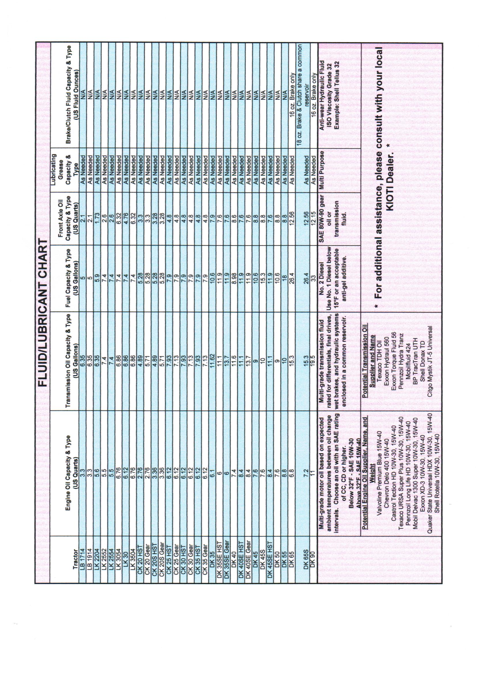

Here is the lubricant chart I recieved from my Kioti Dealer. It list 8 potentiaL transmission oil suppliers. I have always used our local Co-op oils for my tractors and just had my oil guy set me up. I used 80W 90 for my front axle.

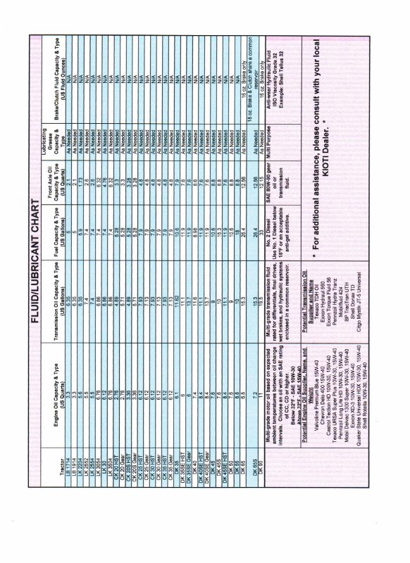

That scan didn't look too good!:laughing: Try it again!:thumbsup:

Thanks for the chart. It lists four more brands than my manual lists.

Hoosier Hay Man-- Thanks for the chart. It does give some more references than the Manual. Still no luck finding those locally. but I've got some more cross references to work from. Did notice some capacity difference from the manual on Capacities on the CK20S HST line. Both engine oil and tranmission differ.
