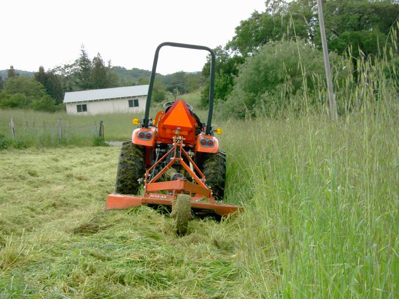

I have the R4's on my CK20ST, the measurement from sidewall to sidewall is 51". I have the Kioti 52" rotary cutter and use it all the time to cut very tall and thick grass. The few times I've come close to stalling is when I've hit LARGE rocks or very thick wet weeds or tried to "blow" thru them a little too fast!
