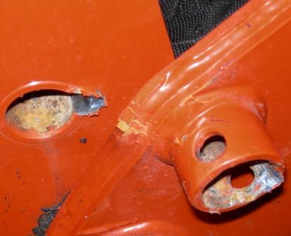

When I got the machine back, they had put in a new rear hydraulic disconnect system. Now I'm supposed to use one of
the main levers to cut out rearward flow when the hoe isn't in use; this is to prevent the same seal blowout that happened before (in normal use). Very classy, though I don't plan to remove the hoe - need it for weight. Unfortunately, they transported it on a different trailer that lacked room to put down the bucket - only way I've ever seen one moved. I hadn't provided the vertical lock pin, since they hadn't used it before. Seems the delivery guy just raised the boom and stuck a bolt in the hole. The bouncing boom smashed the bolt, gouged out the holes, and bent the steel side-plate to the point that I can't lock in the pin anymore. They also didn't do a great repair job on the blown valve: aside from some minor misassembly of the rubber dust boots and a split pin that pokes out where it didn't before, the valve now sticks in one position. So I'll have to pay to have it sent back for re-repair, and also hope they can bash the boom into some kind of shape. It works OK, but I'm very concerned about resale value if/when I can afford to trade up: one look at that, and a buyer will probably assume that the whole machine has been abused.
