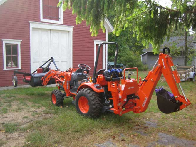

crabjoe said:
It's kind of hard to explain why dirt moving is so important at this time, but I need to move dirt, more then cut grass. Plus, I've already got a lawn tractor and I have a thing for new toys. :D
I guess I misunderstood, but no worries.
I am in NH on 2-1/4 acres. We grow rocks here. see attachment!
I had to carve out some space for a barn and a riding ring for my horse loving wife. My CK20HST has been awesome.
If you sit on a BX, then sit on a CK20 you become immediately aware that they are designed for two separate uses. Nothing against the BX, but I already had a lawn tractor also.
It sounds to me like you will need to get a CK20 with a Box Blade and start scraping off all the topsoil that you can save. Then start digging out the rocks. A BB with the teeth ?? down will loosen the rocks enough to grab them with the loader.
But you might still want to consider renting a smaller excavator with a thumb, that will pop rocks out a lot faster than any tractor could.
So I revise my recommendation, CK20HST.
You can always sell it in a couple years when all the heavy work is done. That was my plan. But I seem to keep finding projects for it to do.
Jim

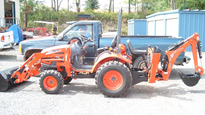

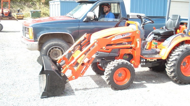

Earlier on in this post, someone posted a picture of two loaders comparing height side-by-side.
My buddy Jeff has a Kubota B7510 w/ 302 loader
In my delivery pictures found here: Index of /ck20_arrival
if you look at IMG_0800.JPG you have them side by side w/ loaders all the way up FYI.
Jeff has an F-250 w/ snow plow package (no plow though) that sits up there (more then an F-150).
The 7510 gets just barely high enough to load it and great care has to be taken not to hit the truck bed. It almost feels like you need a bit more roll of bucket forward to get everything in there. I loaded a bunch of wood into his truck w/ the 7510 before I had my CK20 -- so this is based on personal experience using both machines.
The CK20 and 7510 both had no problems loading my brother's F-350 w/ equipment body (toolbox) setup. They will both have no problems loading an F350 or F450 w/ Heil dump body also. We have not tried loading a 10 wheeler or tri-axle (20 yard or greater) truck... (hope to someday!)

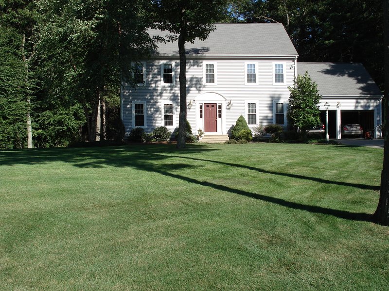

Fresh cut lawn with DMM60 mid-mount deck pictures
   / CK20S HST #52
Beautiful lawn and nice pictures!
   / CK20S HST
#53
What kind of grass is that??? The grass looks awesome!!!!
   / CK20S HST #54
It's the stuff my builder installed when he installed the lawn about 8 years ago. He used a blend from a local "Lesco" distribution center thats a mixture of fescue, perennial rye, kentucky blue grass, and a healthy amount of annual rye to get it started.
I use a local company "Turf Technologies" who does a crab grass treatment in the spring and 6 treatments throughout summer along w/ grub treatment and lime in the fall. They also treated it for a sod webworm insect.
I also have a sprinkler system and that helps quite a bit when things get dry around here.
Just need to change blades and sharpen the other set on the deck -- and change the gear oil in the mower desk transmission and I'll be good for next season. Need to get an impact wrench for blade changes as I like to sharpen often as that helps to cut the grass instead of ripping it which helps prevent it from going brown after cutting.
Very happy w/ my CK-20 "residential lawnmower".
