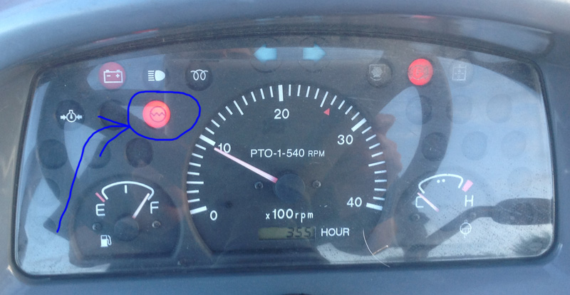

I am cleaning up my tractor after plowing to get it ready for the change over to mowing, and I have a light on the dash that I don't know what it means. I tried going through the user guide from Kioti, but I don't see it anywhere. Here is a picture:
This light came on once or twice very briefly when I was plowing, but went out. Now it is steady on for 5 minutes at start up. I haven't moved the tractor. I am not sure what to do.

Check your battery and alternator connections. Wild Guess??

Level of fluid in the coolant reservoir

After you correct the coolant level, you might want to check the snugness of your hose clamps. The extreme cold, like this past winter, can cause minor leaks at the clamps. Once engine is warmed up, metal expands, leak stops. Doesn't happen so much with new hoses, but after a few years of use the rubber looses it's elasticity....check it out....Hill Billy Bob

Great suggestion. Thank you. I'll be sure to check it out
