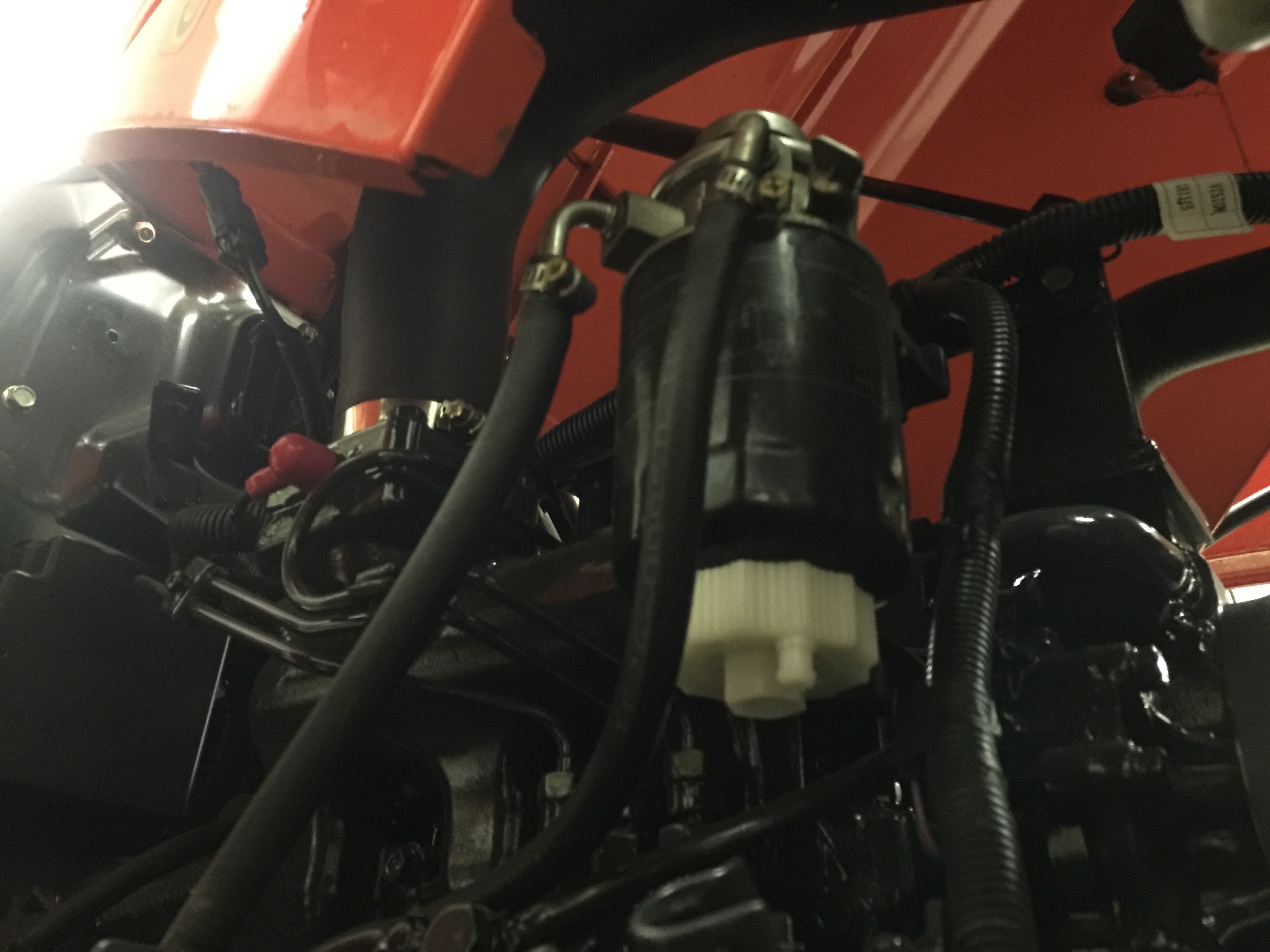

My fuel filter on a 2019 CK2610 does not match the owner's manual (OM) or the factory service manual (FSM) photos. Both of these show an electrical sensor with associated wires being attached to the bottom of the filter for water detection. I can find no electrical connections on the fuel filter housing pictured.
Question: Where is the 'fuel in water' sensor for this style of filter located?

My 2018 CK4010 fuel filter is just like yours, and mine also has no electrical connections to the filter. The water sensor is located between fuel filter and injection manifold or just about 8" down the fuel line coming from the filter.
Got to remember, Kioti makes design changes and may not always update the manuals. I am sure, but not 100% certain, when these tractors were Natural Aspiration, the water sensor was at the base of the fuel filter. When Kioti switched to fuel injection systems for most of their tractors, that water sensor was moved.

Hmmmm, I can see nothing on mine that looks like a sensor with electrical connections on the line out of the filter housing. It goes to the low pressure fuel pump, which then connects to the injector pump. This is the first connection point out of the fuel filter housing. I'll keep looking. Thanks, Toukow

I went on the Michigan Iron Kioti parts lookup website to find your CK2610 water sensor, and on the expanded parts diagrams, I see no water sensor what so ever between the fuel tank and injectors. None.
Choose your tractor model, go to Chassis, go to Fuel Tank Group.

The water sensor is for the common rail engines. The 3A165 in the 2610 doesn't have it as you bought the old school non-emissions engine.
It's all in the workshop manual that can be downloaded off their site.
