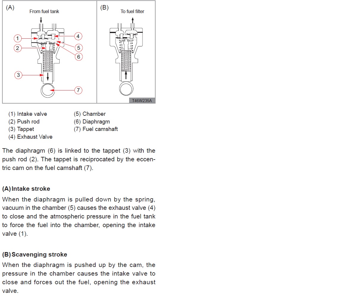

Your symptoms sound like fuel starvation. Usually this is caused by blockage (clogged filters) but it seems you have ruled that out already. The lift pump (as mentioned by Jls) is another likely cause, particularly considering that your fuel filter wasn't full. This is a simple cam-operated diaphragm pump with check valves on the input and output lines. This pump is upstream of the filter so it's possible that crud in the fuel got stuck in the check valves. I doubt the off-road fuel hurt the diaphragm but if the diaphragm is broken fuel will get into the crankcase oil. Give the oil a sniff test. it's probably fine.
A new lift pump isn't super expensive (like $50 vicinity) but you might be able to fix the old one, maybe just by blowing out any crud with compressed air or possibly disassembling it; I'd have a new spare on hand first.
This should help explain how the lift pump operates:
