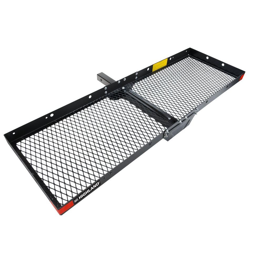

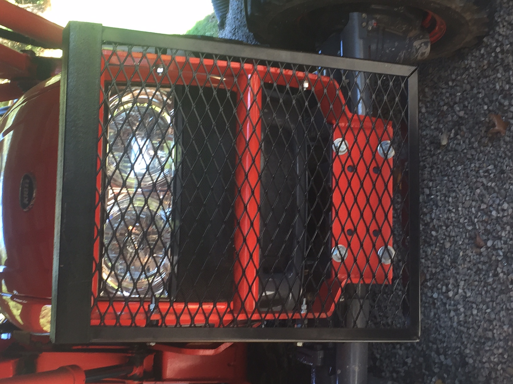

I bought the factoiry bumper grille for my CK30 Not much help when brushhogging
Wanted a metal mesh
Easiest solution was to buy one of those 500 lbs. Capacity 48 in. Hitch Cargo Carrier
Made by Highland
Come in two pieces You only need one half Bolt it onto your Kiotii bumper hitch. Will need 1.25" spacers each side (I used larger nuts)
I had a welder buddy who welded a2.3: angle on the open end
Can of black rustoleum spray
PS I have the other half avialable......if anybody close to Binghamton NY
   / CK30 EASY MESH GRILLE #2
Good idea! Maybe not the prettiest, but sure looks functional.
And, as it happens, I have one of those I haven't used for years. :thumbsup:
   / CK30 EASY MESH GRILLE #3
Get R' Done! Unless you're planning on riding it in a parade or driving around to impress your friends, you should be good to go.
   / CK30 EASY MESH GRILLE #4
Appleo, nicely done. Very clever and functional. :thumbsup:
