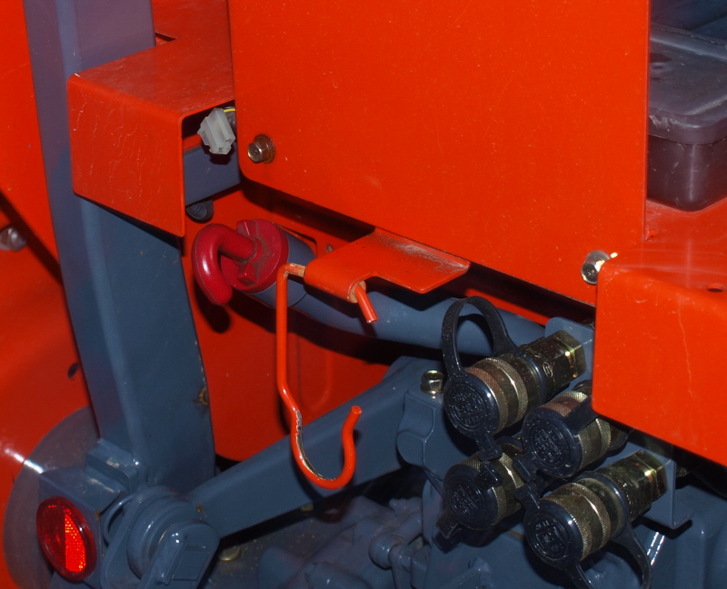

I have a set of worklights I'm going to install on my CK30 and I'm looking for a place to tap into the wiring.
Anyone know what the white connector in this picture is used for? Amd just as important, what's on the other end? I haven't had time to really look it over to good yet but I noticed this connector and another one just like it on the other side.

That connector is for the back-up light, which you don't have. On the right side you'll find two wires with male/female "bullit" connectors (hot and ground), they are for the work light which is only "hot" when the key is on. The other connection I haven't checked.

By back up light do you mean a rear worklight? Or is it wired to come on when the machine is travelling only in reverse?
So the connector on the other side provides +12VDC and a ground? I have a couple nice Carling rocker switches (IP68) that I can mount in the dash plastic. Is there a connector located in the dash that is on the other end of these wires?

The back-up light is the "factory" installed one which is wired to a switch on the "forward/reverse" shuttle control lever (if gear drive). The wires on the right are wired to the fuse box which is hot when key is on. The Kioti work light has a "toggle" switch on the light for off/on.

I ran into something interesting while testing the connectors at the rear of the machine. There are actually 4 drops there. Two have block style connectors but one of them only has one wire. It is located on the right side of the machine. I'm assuming this is for the worklight and it's the power lead? Does anyone know if the Kioti worklight grounds through the mechanical fastener (bolt) that attaches it to the tractor sheet metal?
The two wire connector is for the back up light as stated above. It's located on the left side of the machine (see picture above).
The other two drops are the cylindrical pin type. I got to thinking and maybe these are for ROPS mounted work lights? They are hot with the key on.
