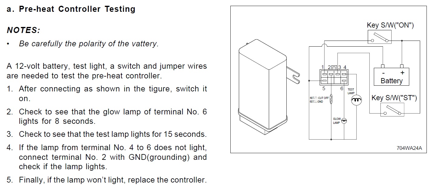

My 2007 CK30HST glow plug light does not come on when I turn the key and the engine is cold. I find I can eventually start the engine by running the starter a couple times for 30 seconds or so - white smoke comes out the exhaust until it catches. It runs fine, warms up and in half an hour I turn off the engine. I then wait a few minutes before turning on the key on again and observe the glow plug light DOES come one and I can easily start the engine. Over the past few weeks I've repeated this scenario. Cold engine - no glow plug light; hot engine - glow plug light. I'm located in northern NJ. My old dealer, Wallace, closed down several years ago. I took it to another dealer here in NJ twice and they didn't fix it - actually I think they made things worse - like brake lights always on, temperature gauge not working - apparently electronic problems. They told me they initially had the wrong electrical diagram, that apparently this model/year had two versions of electric diagrams, that they then got the right diagram, and tried to fix things. But after looking inside the engine compartment I see what looks like electronic relays hanging when they should be held by a screw/nut; and other 'sloppy' things. So forget them. I though I'd invest the time and try to fix it myself but I need help on what to do. I'd like to start with the glow plug problem Can someone point me to a concrete set of steps to perform or videos or ... . I do have a multimeter and a flash light but no diagrams.

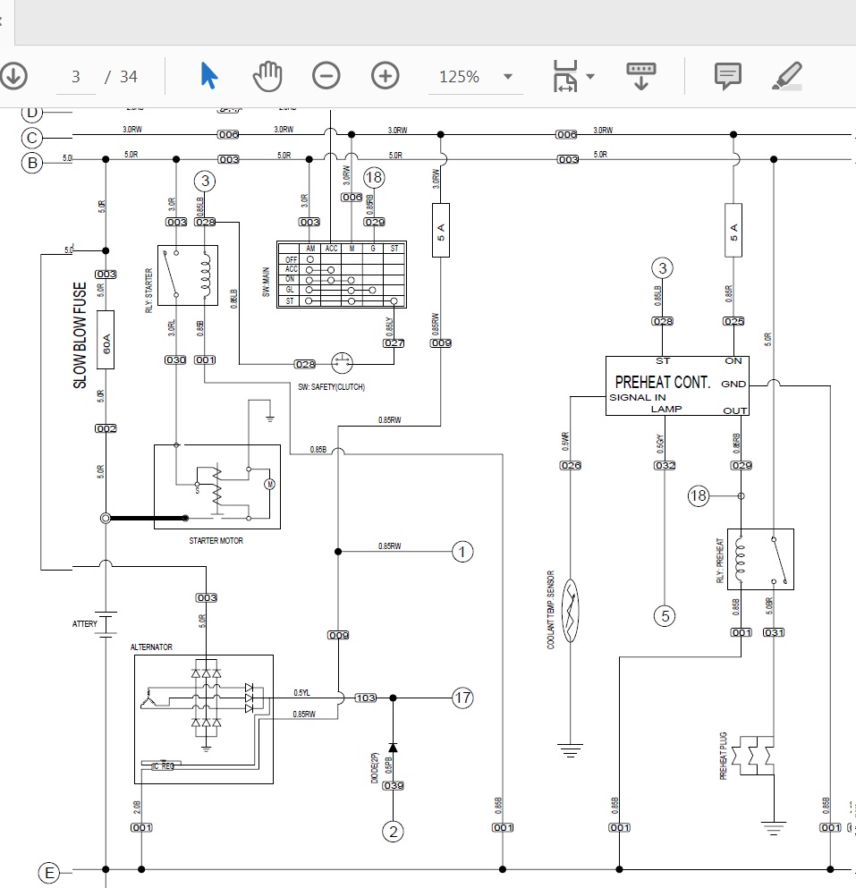

Kioti changed the engine design during the 2007 build year, starting with s/n G704-00079 but I think you have the older version (s/n G704-00078 and previous) because item "C" in your first photo is the preheat controller used in the older version. This is a good thing because the older version is not vulnerable to broken gears in the injection pump and the preheat circuit is very simple:
The glow light works so the fuse must be OK. So either the sensor, preheat controller, or connecting wires are your problem. The book says this about the sensor:
B. ENGINE COOLANT TEMPERATURE SWITCH
The coolant temperature switch is located at the front
top side of the engine inside the thermostat housing.
This switch is open under normal operating temperatures
and closed when operating temperatures reach
higher than normal limits, 53°C, illuminating the indicator
bulb on the instrument panel.l.
This is likely one of the many errors in the manual but it is probably supposed to be closed when cold and open when hot,. In other words it should have read "and closed when operating temperatures are below normal limits, 53C, ...

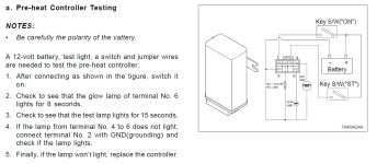

There are also confusing instructions for testing the preheat controller:
Given your symptoms, I suspect the sensor (maybe disconnected?) but the controller could be bad. Here is a link to the parts diagram. I suspect this sensor (#15 in diagram) has a dual function and also operates the temp gauge.

You should have a manual glow plug position between the on position and start if you hold the key in that position it will manually light the glow plugs.
I would first check to see if the sensor is plugged in. If it is then I would unplug it and try jumping the connector to see if you can get it to change states if it seems to change with and without the jumper then the controller is ok and replace the sensor.
