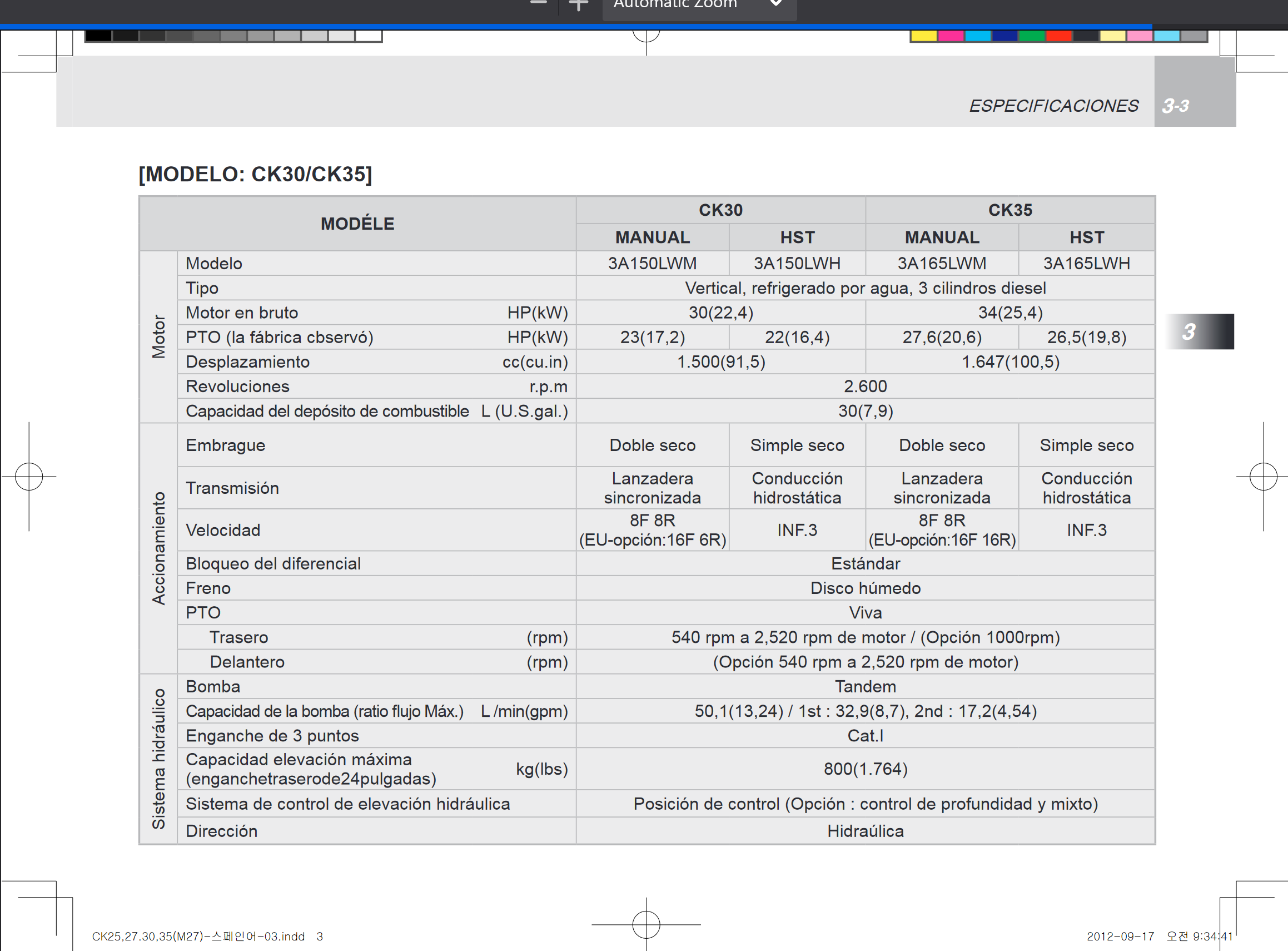

I have a Kioti CK35, bought a Woods BB60 5' rotary cutter. What engine RPM gives me 540 rpm's at the PTO. I've look in manual did not see anything. Max engine rpm red arrow on dash shows 2600 rpm's. Doubt it's that number, maybe lower. I run a 5' tiller at 2200.
I anticipate engaging the Woods at a lower rpm about 1200 rpms, just need to know answer to above.

The "redline" on a tractor tachometer does not mean the same thing as it does on a car. That red line is the PTO indicator for 540 PTO RPM which is 2600 engine RPM. The governor on the tractor is set to protect from over-revving. Best advice is "Let'R rip"!
   / CK35 Engine RMP vs PTO rpm #3
Cant get to your manual in English (do you have one?) but the Spanish version says ~2500rpm for the PTO 540rpm. (tresaro is 'rear')
CK3510's is 2400rpm for 540 PTO. 2600 max engine RPM.
