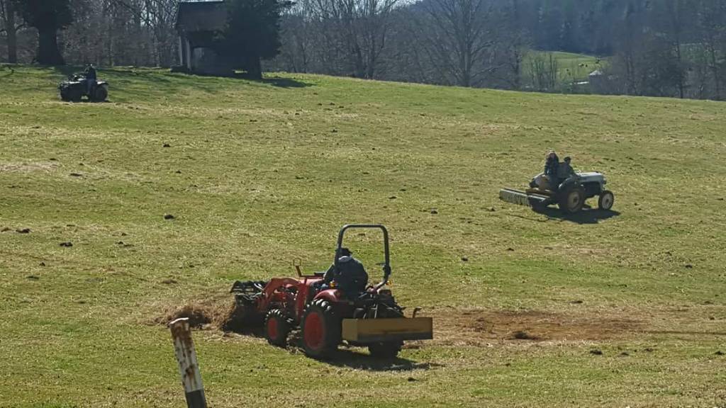

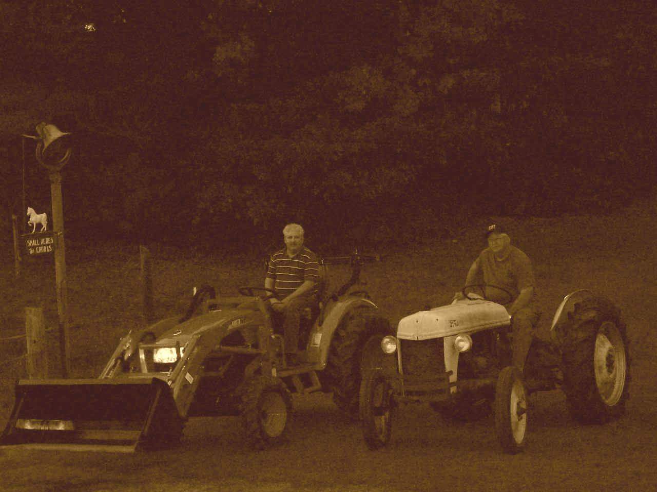

Dad & I on the tractors side by side
Me on the CK, My son & his girlfriend on the 8N, and Pops on the 4 Wheeler making sure we do it right. :D
