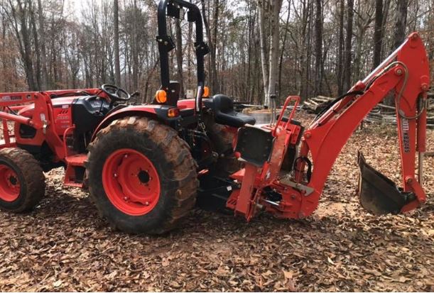

Here's a picture -- factory frame mounted backhoe that the owner did not abuse.

I'm a home owner not crazy heavy work. Digging drainage, trees/firewood/stumps, rock walls, moving bushes, dirt, stone, mulch, etc. I feel the TLB is the best weapon for me and our property vs a traditional backhoe/excavator.
I figure if I can get a good loader/backhoe then I'm in good shape. How did you manage to break that hoe in half?

Not my hoe, but it broke because of poor engineering and cheap steel. Best to buy a tractor with factory installed backhoe. they can be found on the west coast in the 10,000 range depending on hours. Take a old welder/machinist with you and examine the under garage, he will find and point out to you areas that should be reinforced, he will also point out to you areas where piss poor welders were at work and you can bet regardless of the brand there will be plenty of those
