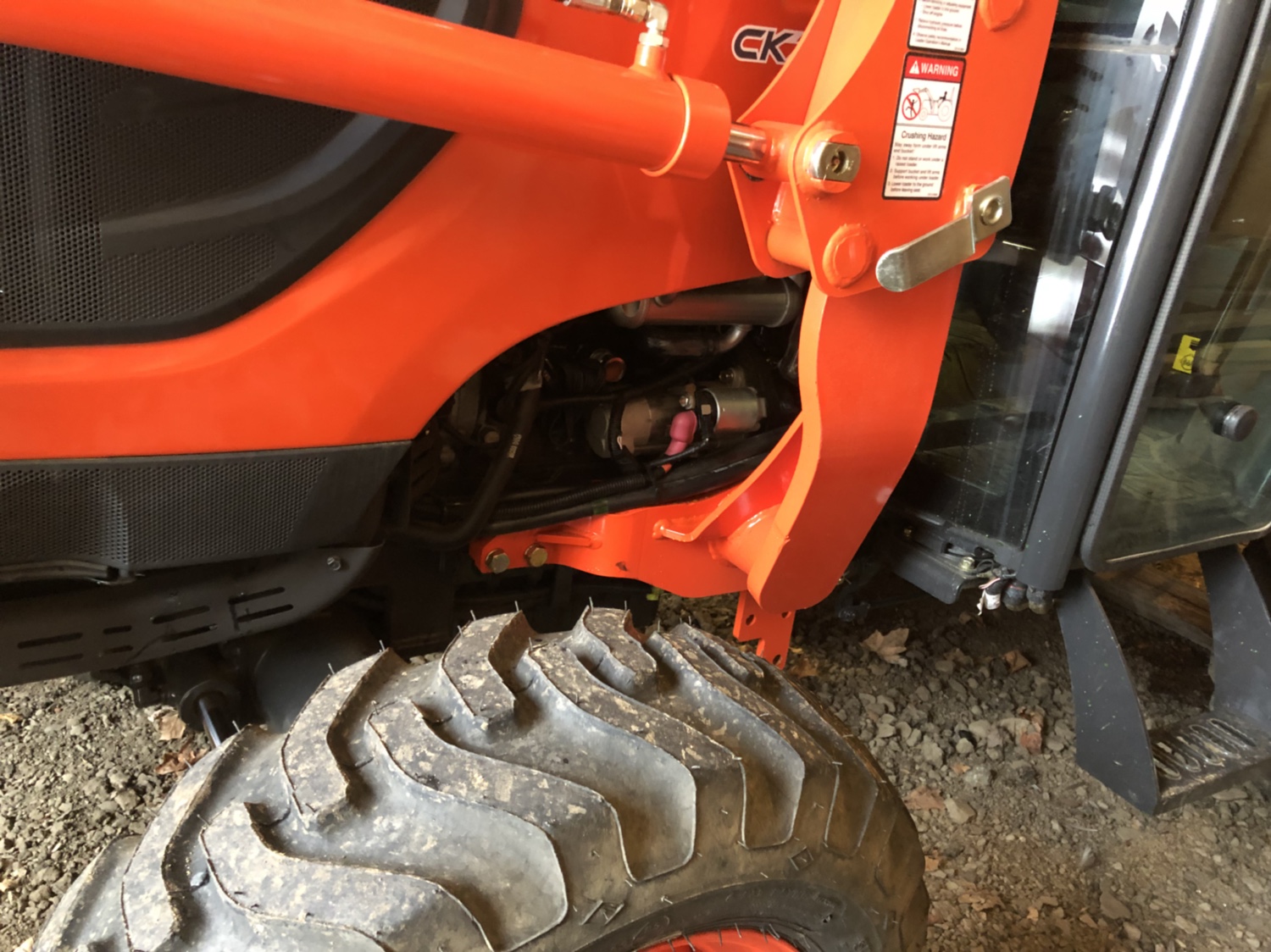

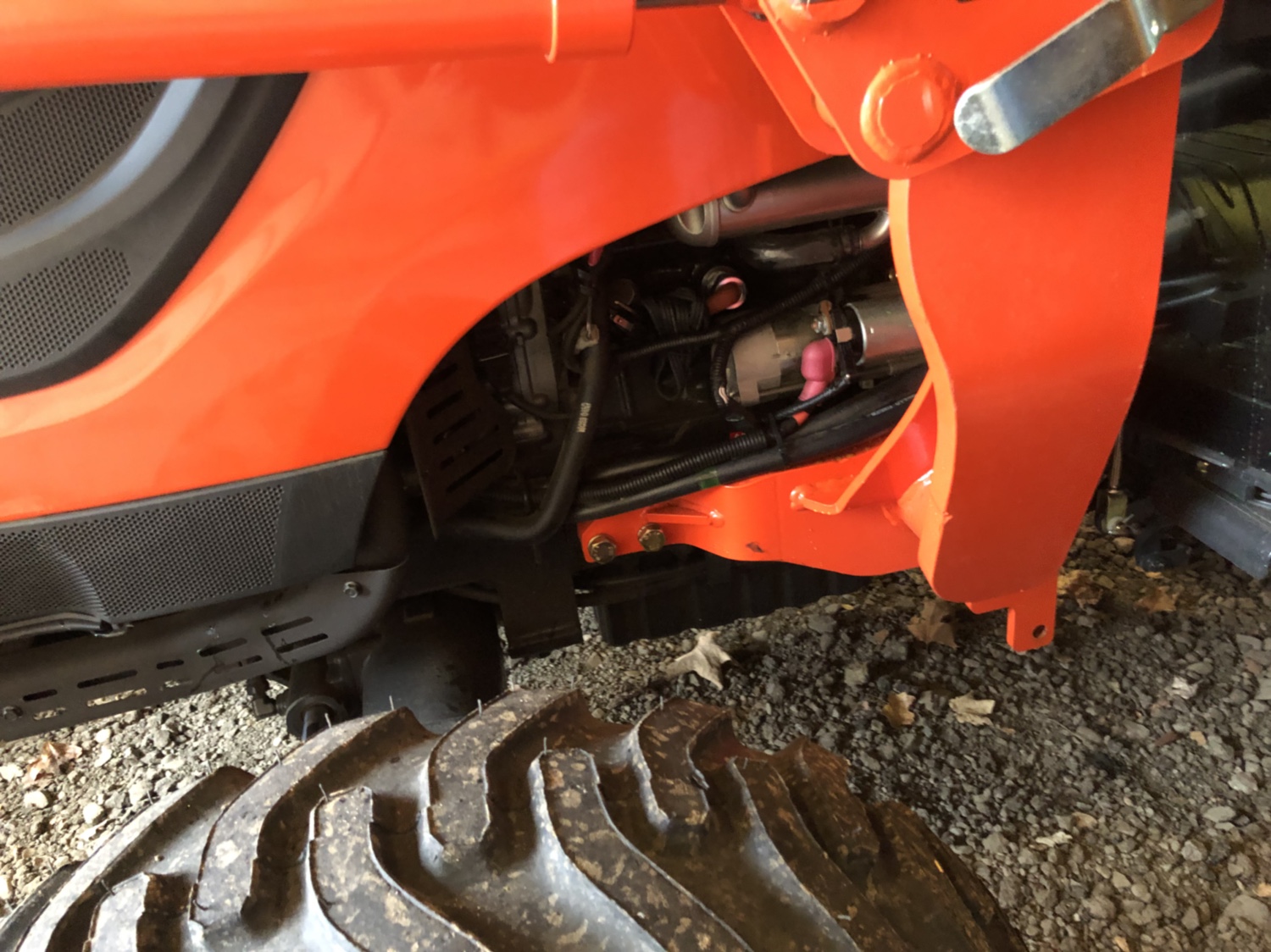

Attached a couple of pics of the factory option block heater I had added. Had a chance to give it a try this morning after a couple days of temps in the single digits. Put it on a timer to turn on 4 hours prior to startup and works very well block was nice and warm, started easier and didn’t sound like it was going to rattle itself apart like sometimes happens with real cold weather. $150 installed seems like a good purchase though I wish the cord was bit shorter but I will fix that eventually.

That's great. I always enjoyed the sound of a warm startup when it was really cold. A suggestion - I would get your 120V power cord a little further away from such close proximity to the engine block. Heat from the engine could, possibly, cause damage to that cord. You are sure correct - that cord looks long enough to go around the block 2X. Perhaps when you shorten it - a better location will be apparent.

I absolutely agree. Going to shorten and Zip-tie that cord away from the actual block. Not a big deal at the moment since even with cardboard on the radiator it doesn’t really get hot enough for the thermostat to open up. Longest cord I have ever seen on a block heater installed in the smallest diesel engine I own! lol
