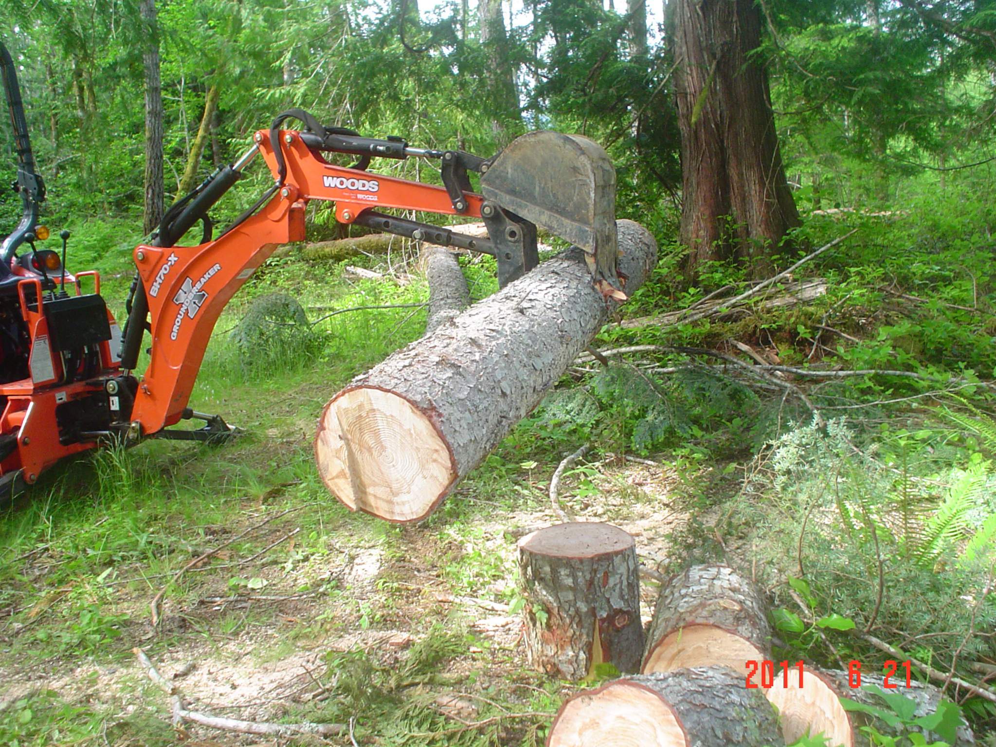

I have a 2008 CK35 with the Woods 7ft backhoe with mechanical thumb, 477 hours.
