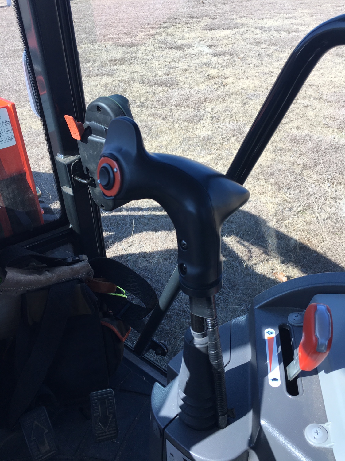

I am currently installing my quick attach front mount snowblower and Im at the point where I need to install the pistol grip controller.
Im looking to see if anyone else has done this and if do how did you run your wiring from the loader controls in the cab to the exterior of the tractor?
Also is there a good location to pull switched 12v power or should I run a new relay from the battery and just control it from a switched source?

Thanks. I think I am going to run a new wire to the battery and connect it to a relay that is triggered by a switched wire that supplies switched power to the switches in the right hand panel for lights and wipers. I just need to now look my cab over and find the best route to get the wiring out to the front of the tractor. Im thinking I may be able to exit the cab through the loader control boot.
   / Ck4010 HST cab 12v power source and cable routing #4
I took my third function control along side the boot and hollowed out a notch in the plastic panel to allow the cable to go outside the tractor.
