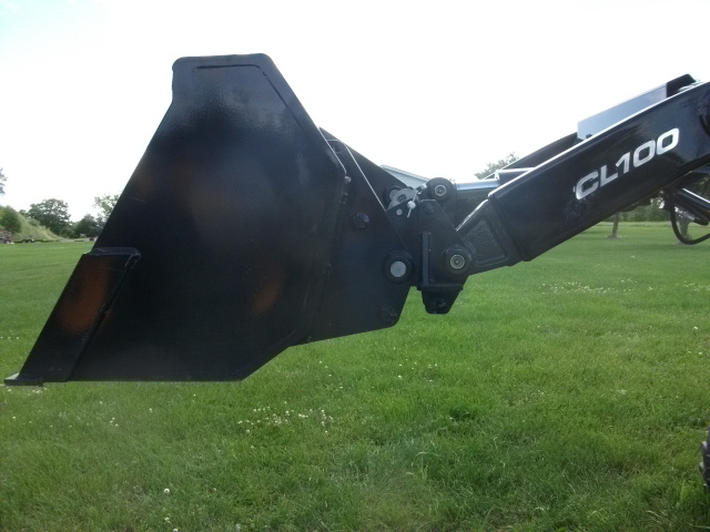

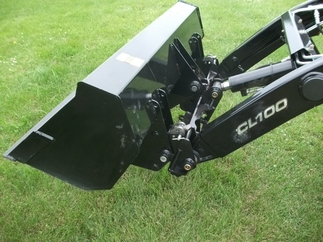

Thanks for the info. I was just wondering as I haven't seen any quick attach items for the loader and I asked my dealer about it, and he said it would be to heavy so I'm going to see if the holders from the 200x jd loader will fit on the cl100 and if they don't, see what it will take to get them to fit as it would be nice to be able to change buckets, grapples, and other attachments easier then having to unbolt them each time I want to use something else.
   / CL100 Loader #5
Did you mean something like this?
   / CL100 Loader
Yes something like that. I had posted something on one of the other forums, can't remember which one, a few months ago when I had looked at your quick attach items for the bx. The loaders are very similar in design so I figured it wouldn't be long before you made something for the CL100 loader.
Thanks for posting.
