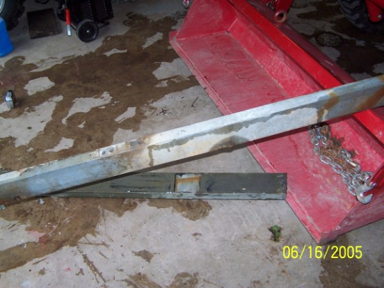

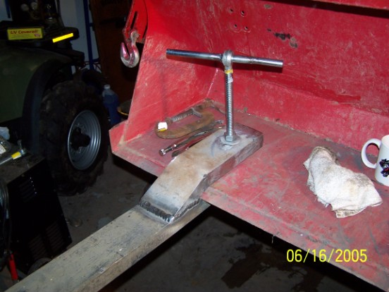

I saw MadReferee's post on these and thought I'd build my own. First pic is the channel I picked up at my local recycling yard.

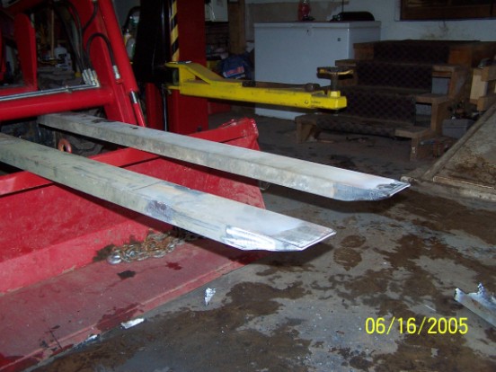

#2
Next pic is cut to length and tips angled. Channel is 4"x 1 1/2"

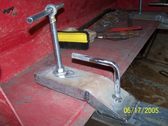

   / Clamp on Bucket Forks
Lift handles welded on

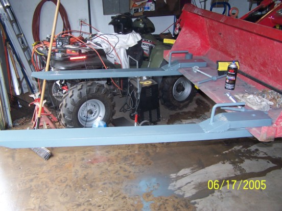

Primed

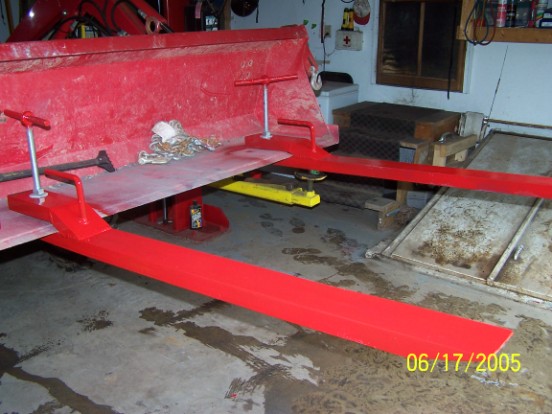

And painted

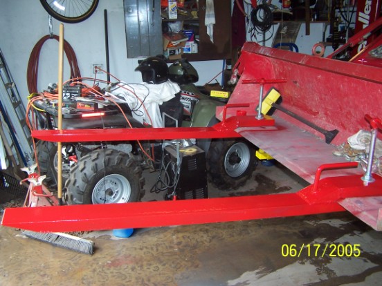

Another view
Just slide on and tighten down.
   / Clamp on Bucket Forks #9
Nice Job ! /forums/images/graemlins/grin.gif
They look good.
Are they Hollow?
Yes, They are hollow underneath. But I think the channel iron is still strong enough to hold anything my bucket is going to lift anyway.
