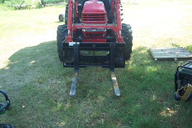

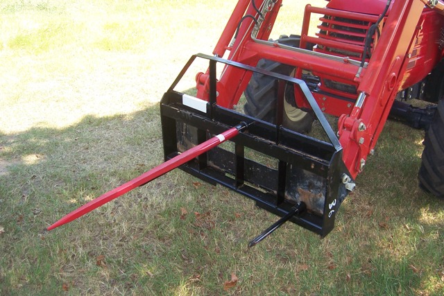

If your bucket is QA ... this combo works great. The hay spear and the pallet fork interchange on the same unit.
