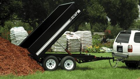

Does anybody own one of these and how does it work?
These units clamp to your loader bucket so you can easily move trailers around. I can't seem to locate many manufacturers....Found one on Ebay and one from Paynes Forks. Does anybody know of any others.....just to compare price and quality.
-Thought about just drilling / burning through the bucket and screwing in a ball, but decided not to in light of the heavy loads I'll be moving (5,000+ lbs) with dump trailer.

I've got a hoe on the rear of my machine that will be used to load the trailer, then move it with the loader attachment with 2 5/16th ball. That's the plan anyway. We'll see how it works. Thanks for the thought anyway.
