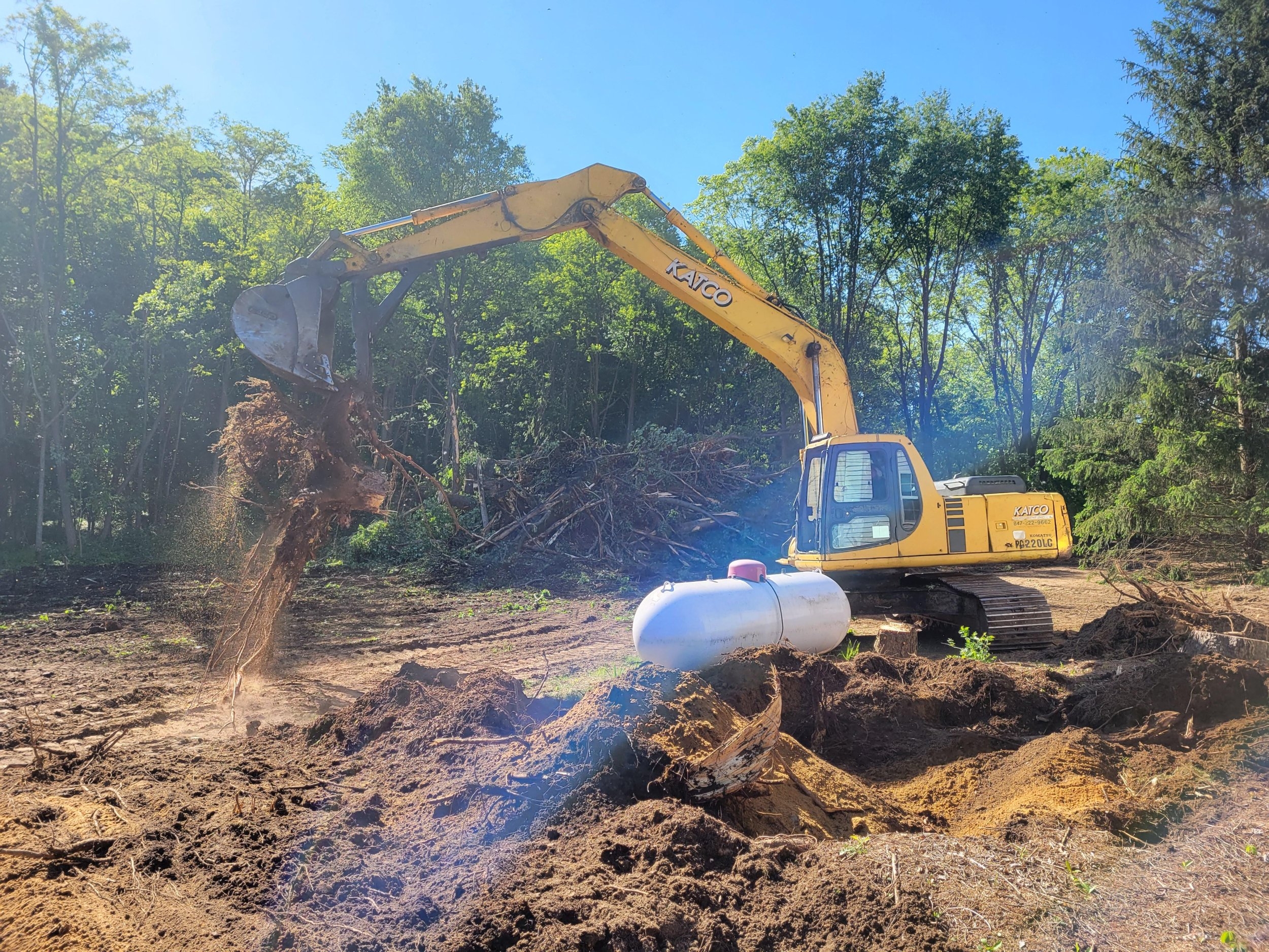

Excavator and a dozer with a rake.. and maybe a skidsteer to help move and stack. Should be able to just push over most trees with the excavator, no need to cut.
