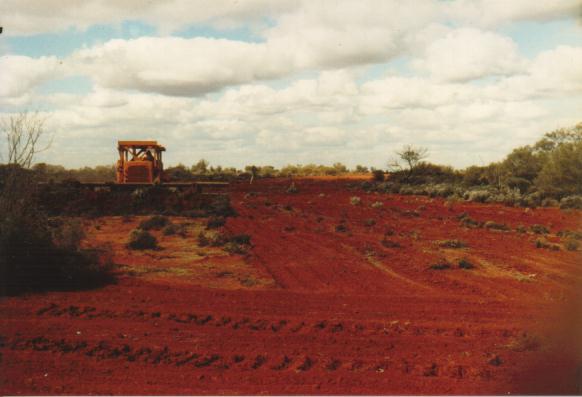

Depends on the model of Dozer. The D6R has the same hp/weight over the older D7s.
Here's a D7F from the late 70's. This is Austraila in the scrub land. The rake is 21ft wide and folds up for transport.
