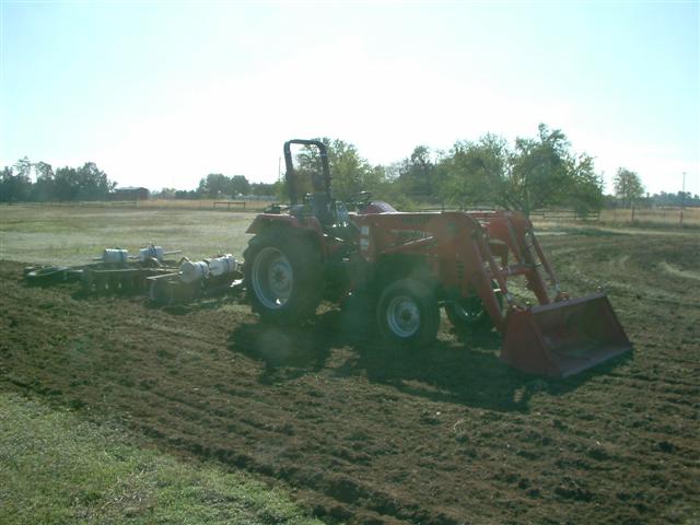

I'm guessing that this is what you want the results to look like. See photo below.
This land was simply cleared of a few trees, disced, dragged, and then rolled with a cultipacker.
Since you have a portion of the land already planted in Bermuda it would seem reasonable that Bermuda would grow fine without going through a lot of chemical prep and alterations.
I'd recommend clearing the land ASAP. That will allow the remaining tree roots to start to decompose. Erosion will not likely be a large factor since the excavator will sufficiently work the ground so most of the rainwater will soak in or puddle in the worked areas. The tracks will chew up the ground enough to make discing later somewhat easier.

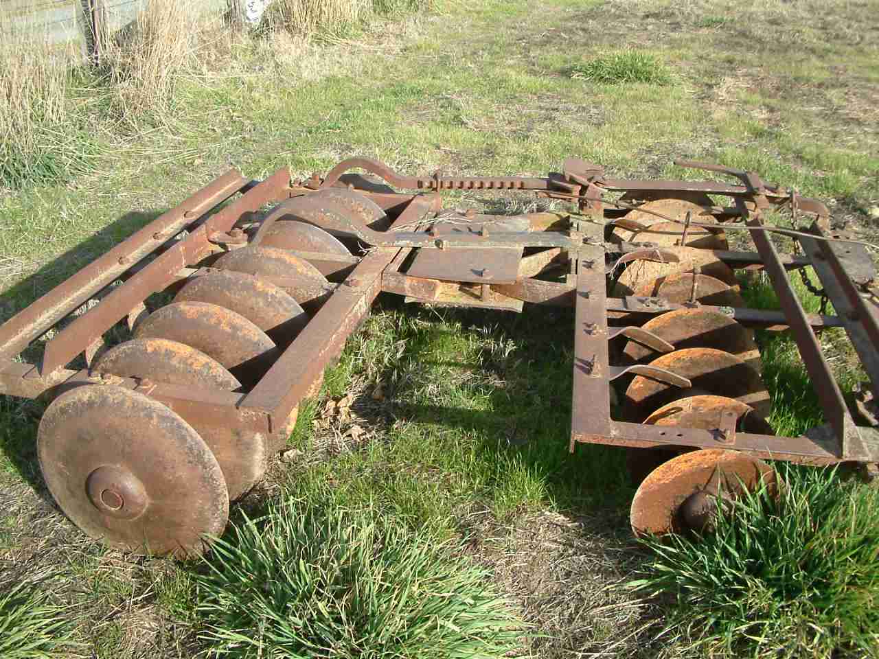

Notched disc blades work well in turf or compacted ground since the implement's weight is concentrated on a smaller area of the blade. Smooth discs do a better job of turning the soil in my opinion. From what you describe, the disc will only be used for this prep and then the land will then be permanent pasture. You can re-sell the disc so don't skimp too much on the price.
The land will need to be dragged smooth. Lots of way to do this on the cheap. A piece of chainlink fence and something to weigh it down (like pallets wired on) is the most simple. Lots of threads here on TBN about the process.
After laying down the seed a cultipacker will do the seed prep job in one, or maybe two, passes. Once again, a cultipacker can be re-sold for what you paid for it.

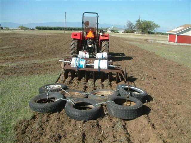

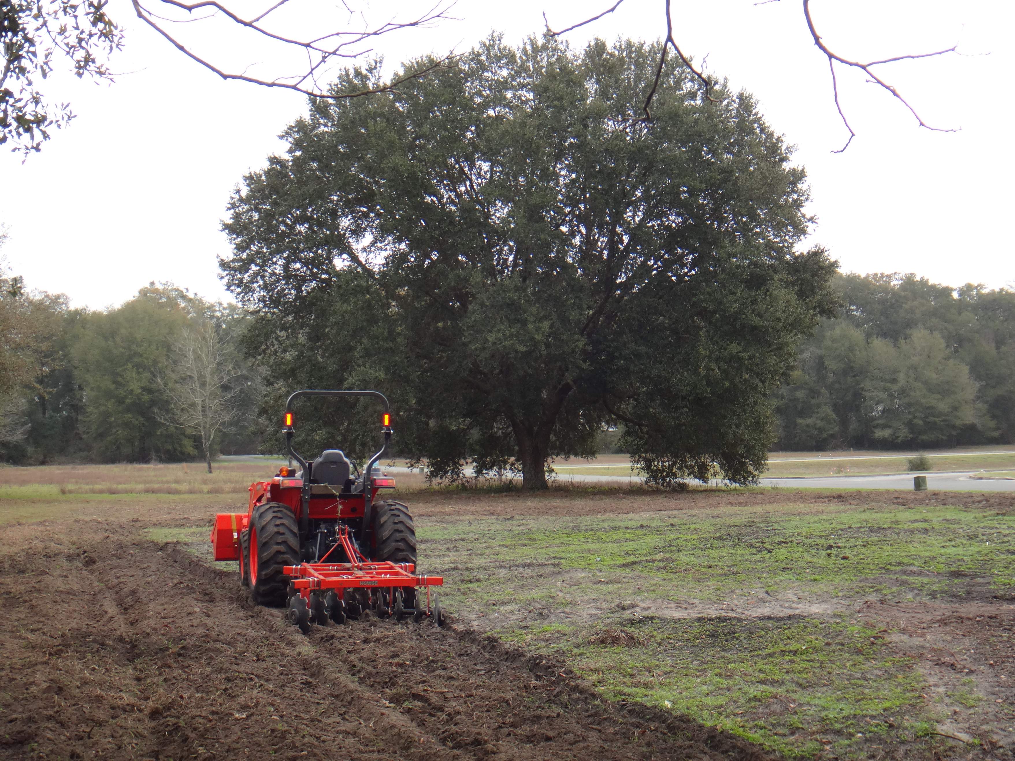

Addendum:
>A landscape rake is not really the best for your application. It sounds good but doesn't work as well as imagined.
>A drag offset disc rather than a tandem disc (both shown in photos) will do a smoother job.
>A small landplane is also shown but from your description the land is fairly well flattened. A simple drag should work.

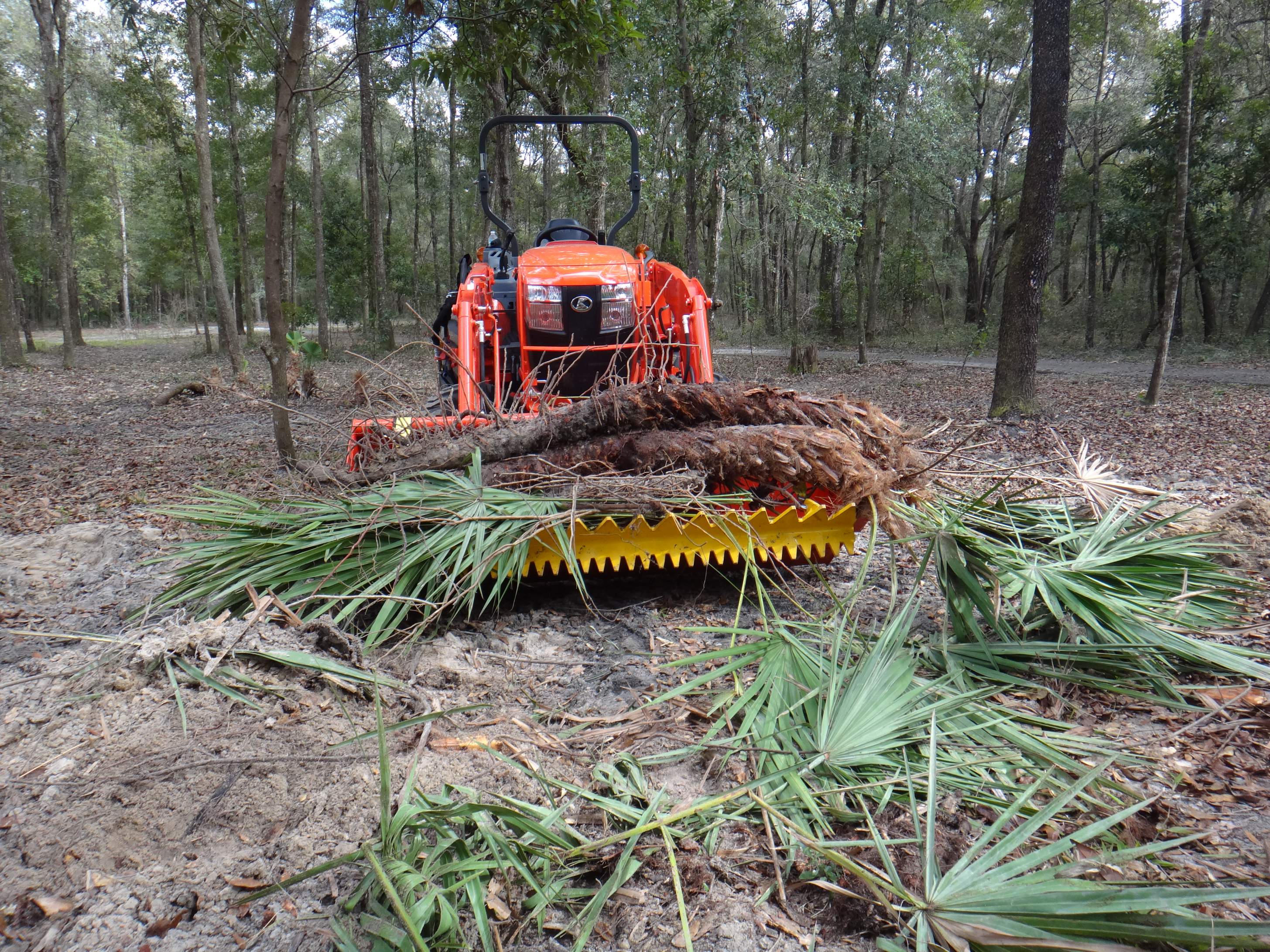

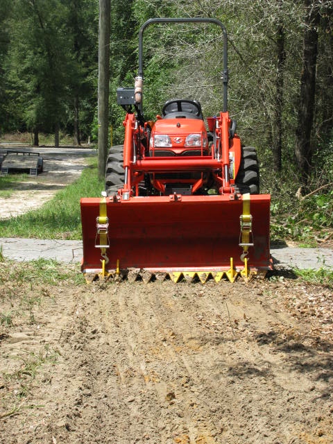

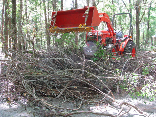

Anytime clearing, raking and minor grading is inquired about here I recommend a Ratchet Rake.
If you are concerned about potential erosion plant as soon as the soil is moist 3-4 days of rain are in the forecast within a week.
In regards to prep: Do not go over your land more repetitions than necessary with tractor and implements. You will be compacting the Georgia clay beneath the area you work with each pass, which will be to the long term detriment of soil quality. If you compact the subsoil and horses compact the topsoil, soon you will have a BRICK.
Ratchet Rake, LLC - Rip and Dig, All Terrain Rake, Snow Edge, Tractor attachment, Bucket attachment, Loader, Skid loader, Kubota, Skid steer, Landscape rake, Brush remover, York Rake, Harley Rake, Rock Rake, Tractor rake attachment, Construction atta

Jeff, I don't believe nsfab has a loader so the ratchet rake isn't going to help.

Once you get the stumps and lateral surface roots removed, I'd go with a small offset disc and a home drag. Here's what I use for my 6 acre hayfield.
The disc is an old 6.5 ft wide Towner offset that a neighbor gave me. I cleaned it up and replaced a few of the pans that were worn. The drag is just a few old wheels that I got free from another neighbor. Just chained them together and hitched it to the disc. The white things on the disc are 120 lb concrete weights to help the disc work better.
Good luck
