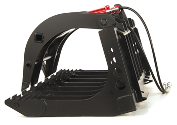

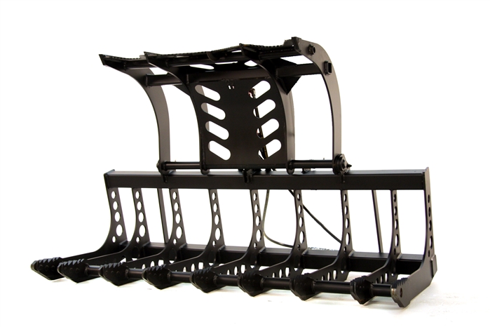

Any buddy ever purchase one? this is the specs SD model. I would like feedback thanks
" NEW 72" SD ROOT GRAPPLE ATTACHMENT
Universal Quick Attach - Fits Most Makes & Models
New 72" SD Root Grapple Attachment Tractor Loader Bucket Rake Kubota Mahindra 6' | eBay
"You are looking at a New Standard-Duty(SD) 72" Root Grapple attachment for skid steer / track loaders and compact tractors. Constructed from 3/8" thick T-1 and A36 grade steel throughout, this root grapple features two(2) independent dual grapple assemblies powered by two(2) American made 2" bore x 10" stroke 3,000 psi cylinders. The main frame consists of two(2) 4" square and one(1) HD 3" round pieces of tubed steel supported by nine(9) 3/8" thick steel tines spaced every 9-10 inches. The optimal tine spacing allows dirt, debris, smaller rocks, and other unwanted loose material to fall through and remain on the job site. With fully enclosed cylinder covers, greaseable pivot points, Parker hoses and flat-faced couplers, this an excellent grapple for any machine under 50 horsepower. The universal quick attach plate fits most makes and models of skid steer loaders and compact tractors. This HD grapple is ideal for picking up and moving: rocks, logs, brush, scrap, debris or any other odd shaped or hard to move material. Weight is 605 lbs. Available in 60", 66", 72", 78" & 84" sizes. Compare & Save. Made in the USA!
(NOTE: Pictures show 66" model)
SPECIFICATIONS:
Constructed in the U.S.A. with 3/8" thick American made steel
Two(2) HD 2" bore x 10" stroke American made cylinders
Dual grapples operate independently for uneven loads
Nine(9) HD 3/8" thick tines spaced every 9-10 inches
Universal quick-attach mount fits most machines
Gusseted grapple tines for added support
Recommended for machines up to 50 HP
One year limited factory warranty
Fully enclosed cylinder covers
Greaseable pivot points
36" grapple opening
605 lbs"
I like how this has guards over everything and there SD duty is like a HD model in other brands

What tractor?
What lift rating?
Have you considered this lighter, but stronger grapple? Single Lid Root Grapple
   / cleveland attachments root grapple #5
605 lbs - Deal breaker, for me!
