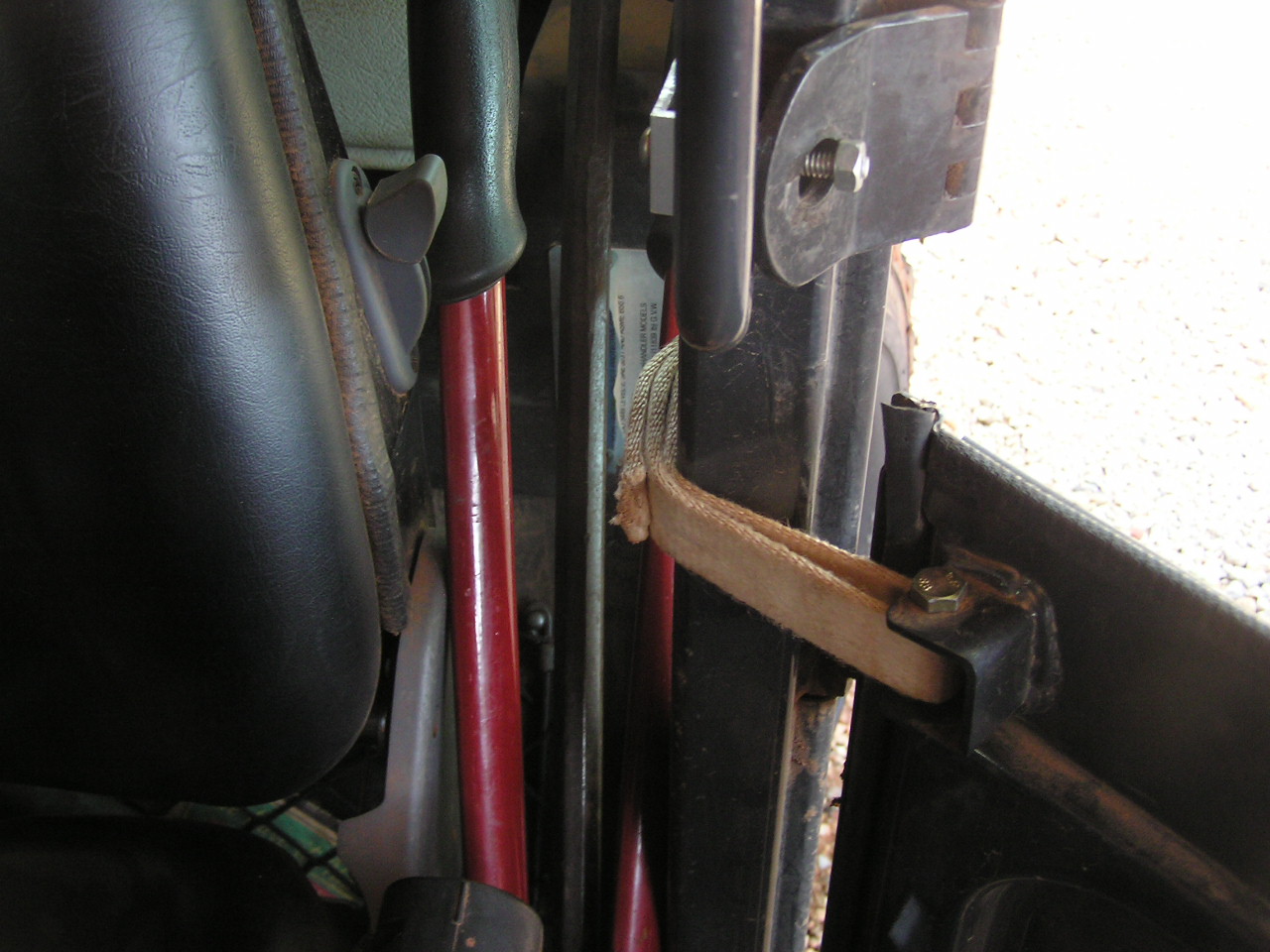

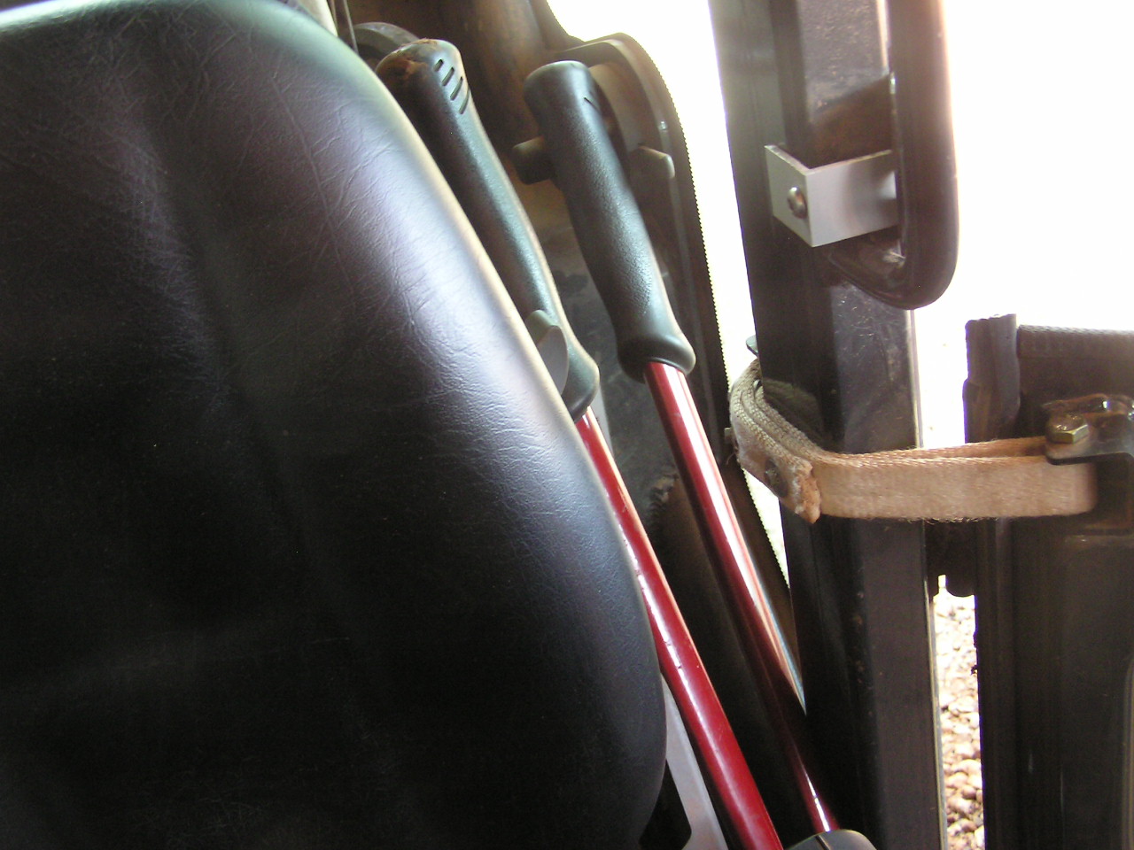

I had the same problem on the Versahandler. Fortunately no glass was broken. I had some thick nylon strap, but no way to stitch it together, so I made a loop and bolted it together with machine screws, nuts and fender washers.
It works gooder-un! :D :thumbsup:
Guess I should do it to the Toolcat before the original strap breaks.
