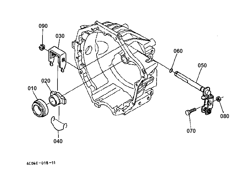

According to my B2400 HST parts book, the clutch feeds power from the engine to the HST pump. The HST pump then acts like a geared transmission in that the power is connected from the clutch to the rear wheels. Therefore the clutch can be partially engaged which would then feed a proportional amount of torque to the wheels.
FWIW, I think Henro's thoughts are right on the mark.
Are you sure the clutch-fork is engaged against the throwout bearing (not sure how to test that)?
The attachment shows the B2400 HST clutch housing and bearing.
