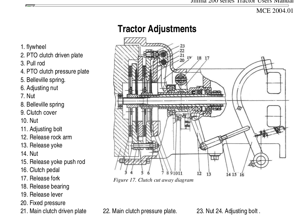

May 4, 2022 / Clutch orientation #1 A avanbre New member Joined May 8, 2015 Messages 8 Location pinon hills, ca Tractor satoh s650g I got a basket case jinma 284, do the longer splines of the clutch packs face the engine? I hVe an 8" dual clutch
May 4, 2022 / Clutch orientation #2 P piper184 Platinum Member Joined Sep 6, 2019 Messages 510 Location Central, ND Tractor Jinma 284 does this image help any?
May 5, 2022 / Clutch orientation Thread Starter #3 OP A avanbre New member Joined May 8, 2015 Messages 8 Location pinon hills, ca Tractor satoh s650g I found a clutch splitting g procedure on keno tractors website. The long end of the hubs face toward the back end of the tractor, thank you. Quite interesting putting a tractor back together that you never saw together
