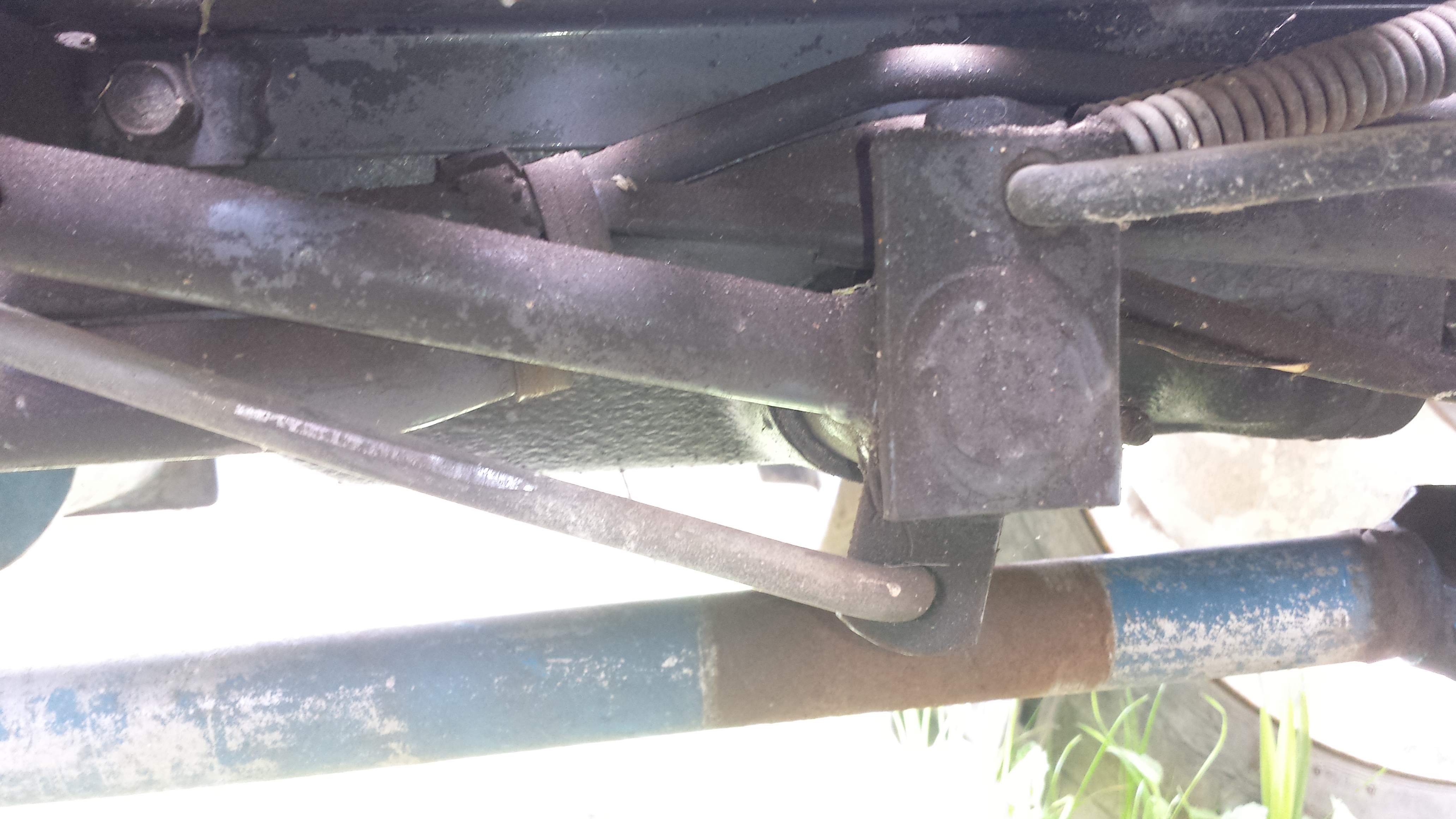

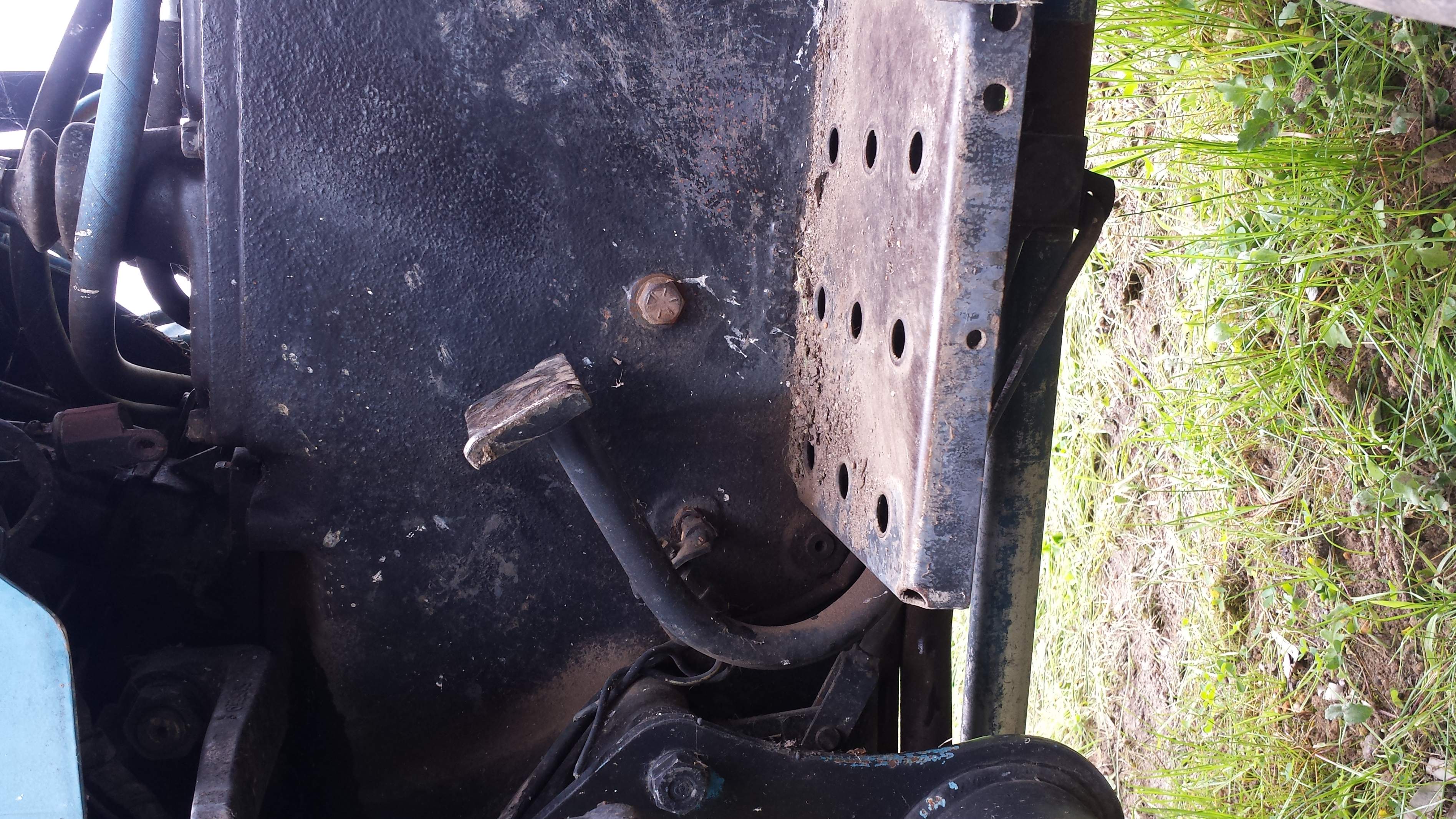

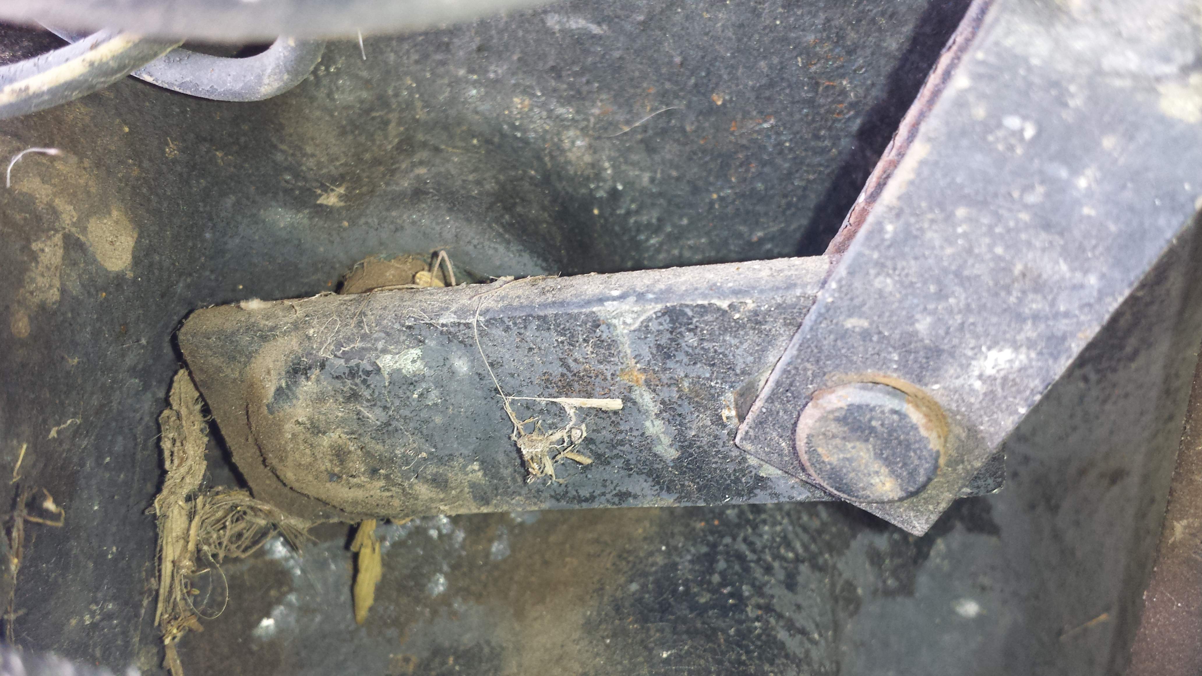

Hi guys. Sorry about the late reply. I've been away from the computer and I need to destress about the tractor. I've just taken some pics of setup to give you guys some idea of the tractor. In reference to the throwout bearing, if it's the same thing as what we call here the thrust bearing then you guys might be on the money. I've been hearing that thing complain ever since I first got the tractor. I've tuned out to it now but I think it's the high pitched scream in neutral or with clutch pressed. There's a bit of background to my first worries so I think I should fill you all in on that too.
All was going well til one day it seemed that the brakes and the clutch suddenly just almost completely failed at the exact same time. The tractor wasn't under any load that day. I still had a small amount of capability with both but getting it to stop was dangerous as we were using the fel to lift someone high enough to bolt a large shed frame together.
The only thing we could think to do was adjust the two rods that run underneath either side to the wet brakes. This had no effect except to snap one of them - the one connected to the clutch pedal. Anyway I've been driving it since then with very little clutch. I have to stand on it and wait for the revs to drop to put it in gear. Once going, I don't have too much problem.
In answer to, can I change gear with the engine off? The answer is yes.
The other day when I said something popped, that's exactly what it felt like under my foot. Tractor went into gear, I felt/heard the pop, reversed but then couldn't brake or throw it out of gear so as I was approaching the fence fast, I dropped the revs off via the manual lever near the steering wheel. 20140812_113115.jpg20140812_112952.jpg20140812_113222.jpg
