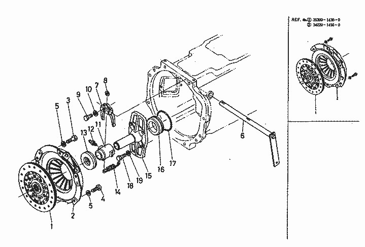

Is the throw-out lever moving with the clutch pedal and returning to it's normal positioin? I'm not sure where it's positioned on a 245DT.
I believe it's #6 here, and it does move as usual when I depress the pedal:

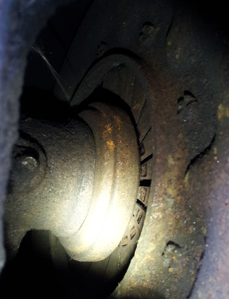

I opened up the inspection window and I think I have the answer. 1st the good: The throwout bearing moves back and forth as it should when the clutch pedal is depressed and released. And, the pressure plate is definitely attached to the flywheel and spins with the engine running.
But, when I opened up the window, I could that the release levers were not all perpendicular to the bearing (see pic, especially toward the bottom). Also, I can see some fibers in there. My guess is that the disc suddenly disintegrated (Is that possible?), removing the pressure from those fingers and explaining why suddenly the clutch pedal felt lighter. So: I think I need to do a typical clutch replacement. I'm thankful it's not the transmission!
