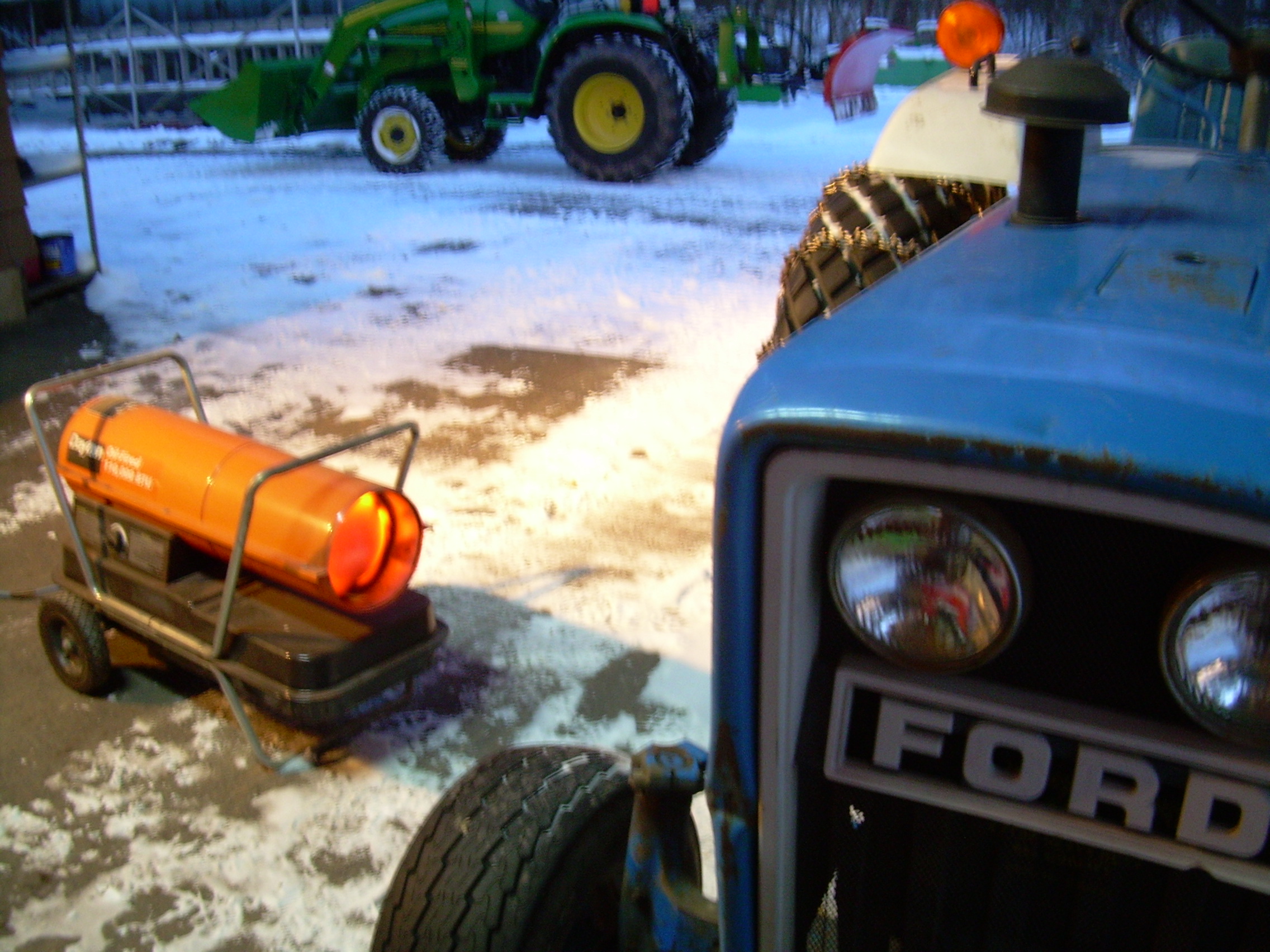

I've got an ornery starting Ford with 2700 hours, that requires glow plugs even in the summer, it will start with glow plugs in the winter but takes a few restarts to keep it going. I put a radiator hose heater on there and that helps with not needing the restarts.
I wanted to try something else just to see if it would work in case I forgot to plug the electric heater in or if battery was low. so I took one of those kero fired construction heaters and aimed it right at the pump side of the machine from about 5 ft away, for 10-15 minutes or so on a very cold day.
It worked, it fired up, figured it heated the block, the fuel system, the air around it as well as the intake air to some degree.
At least I know in an emergency I should be able get her going.
Great idea! If you stand in front of it while warming the engine, you can dry your hair too.;):D
   / Cold starting trick #6
I used that method on a hard to start older JD last winter when my block heater went out and it works really good. Word of caution : Don't use this method on a gasoline tractor :)
