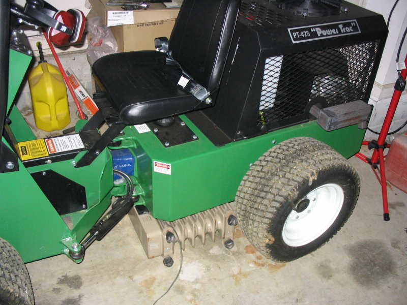

I mentioned in my stuck in float problem on using the oil filled radiator type heater to start my 422. I read someone's post a while back and there was an attachment showing how the person had the heater laying on it's side under the oil tank. The first time I slide the heater under the PT it didn't start and then realized I didn't have it pushed forward enough.
It worked after moving the heater forward but had to raise the back since the heater has wheels on it and they were keeping it from sliding forward. I let it set for 20 minutes and fired right up. Hope this helps.

Here's the pic of the radiator under the tractor. Someone also suggested putting a moving blanket over the engine compartment to keep it warm.
