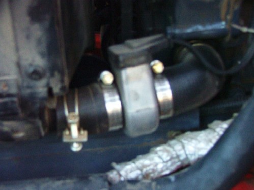

I just put this 300w 120vac radiator hose heater on my CK30HST last week, it promptly went down to 20 deg F and when I leave it turned on for a couple hours, it is nice and warm and starts without the glow plugs.
Mike
