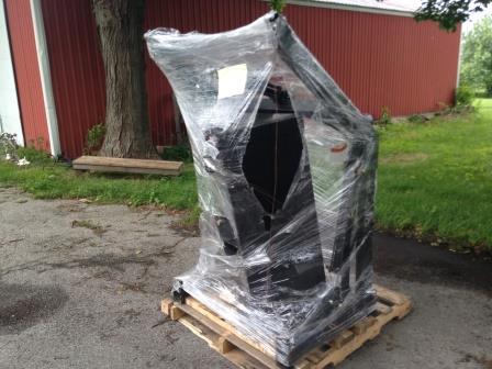

I recently purchased a new Frontend Loader from Coldwater Tractors and wanted to do an updated install write-up.

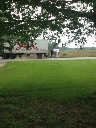

The loader arrived late one evening and I was happy to see it. The freight company had a few issues getting it the last leg of the trip but it finely arrived and in good shape. Curiously it was covered in coffee grounds I suspect that it had a fight with a load of coffee and won.

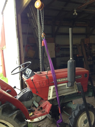

The loader did not come with any real instructions but once I unpacked all of the parts and started the install it all started to be real clear how it goes together. To make the job easier I installed a beam and brought a cheap chain hoist and I am very happy that I took these steps.
The first step was to mount the undercarriage. This went smoothly and only took a few minutes.

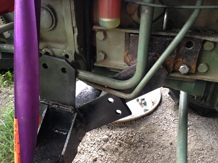

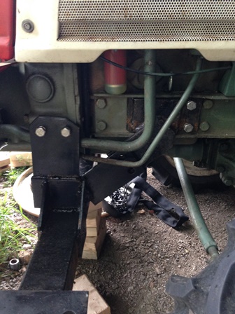

The second step was to mount two flanges one on each side of the tractor. This step was a bit more of a pain because one of the flanges were in direct conflict with the hydraulic lines. With a little force and a bit of luck I was able to get the plate under the lines. If I had to do it over I know now that I should have unhooked the high pressure line to make it go better.
Once I got the bracket plates and the undercarriage all connected loosely I moved on to the loader arms. This step was the quickest as it just fell into place and bolted right up.
