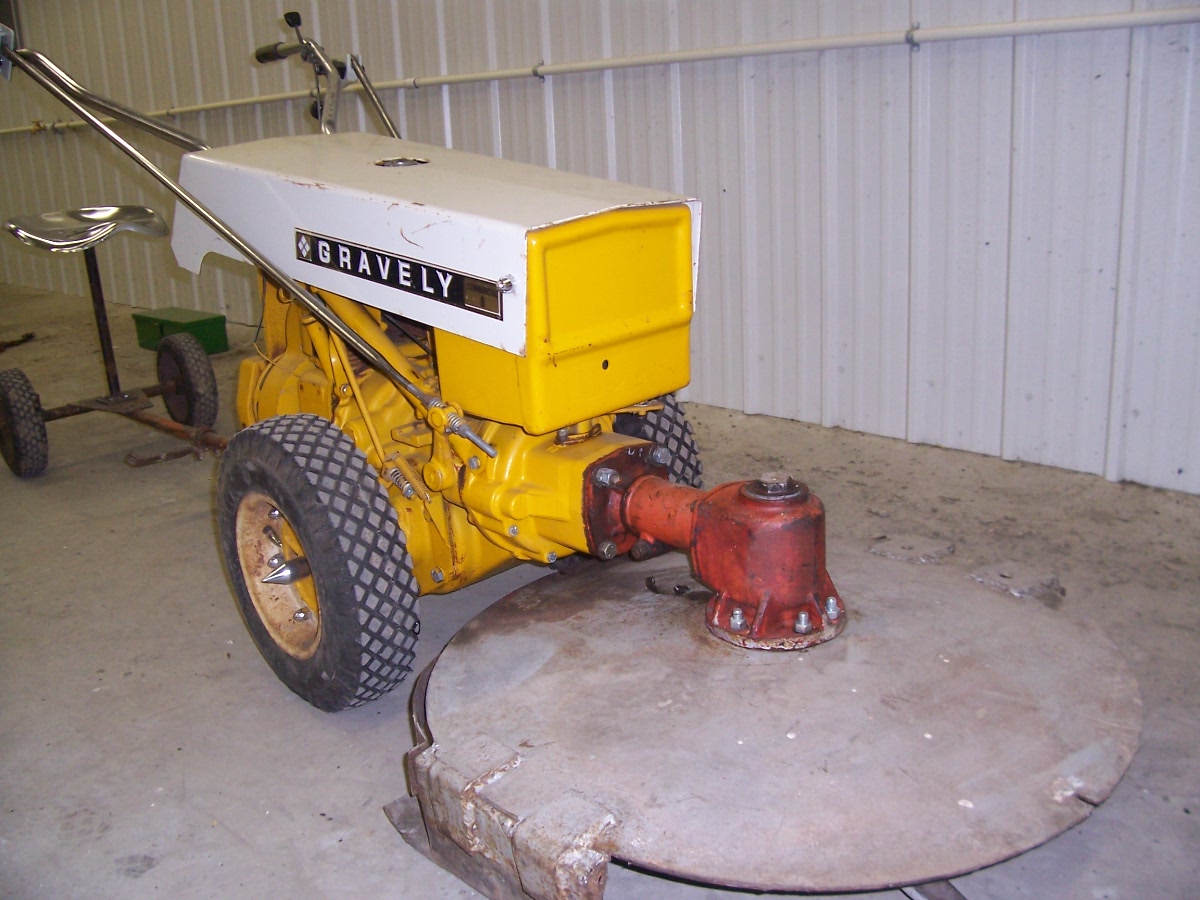

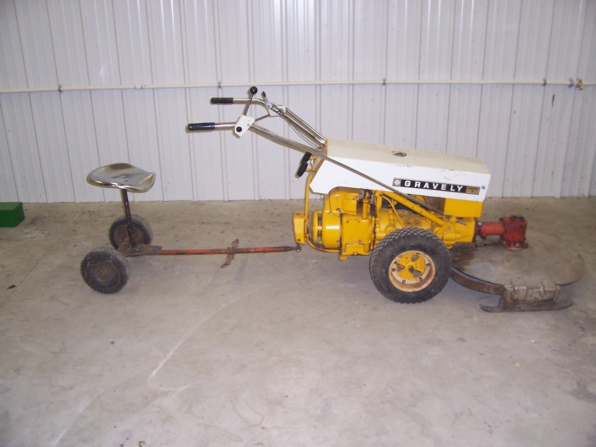

#11
Do you know what year this Gravely commercial 8 is. The serial number is J-68978. Tomorrow After school I will post some pictures of it.
/ commercial 8 gravely
#13
Here are the pictures of the gravely with the rotary mower on it. We also have a rotary plow on a Gravely L and we have a sickle mower and a rototiller. I would like to get a snowblade for it but thats further down the road.
