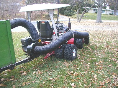

   / commercial lawn sweepers #8
Yes, I did upgrade to a larger turbine (14 inch dia), 8 inch dia. hoses, and a 13 hp engine. The turbine parts are from a Trav-Vac truck loader. This system now is well matched to my 72 inch deck driven by a 31 hp tractor (Ventrac 4200). See photo and 2 more to follow for details.
JackIL
   / commercial lawn sweepers #9
Closeup of 13 hp Vanguard engine and mounting details.
   / commercial lawn sweepers #10
Rear quarter view of high capacity Trac-Vac turbine and hoses.
