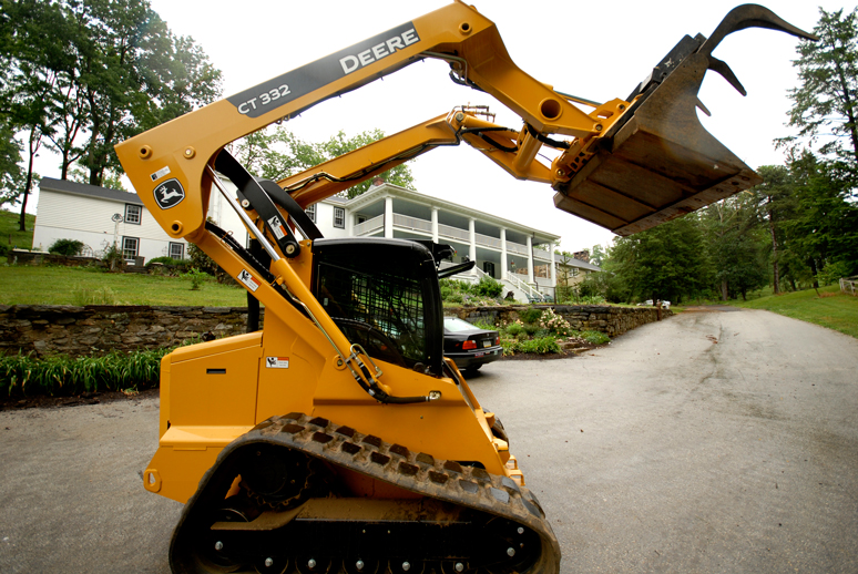

I have owned a Bobcat 763, Caterpillar 257, and now a John Deere CT332. I will never again buy a new Cat skid steer given my experience. It had an engine fire which Cat did not cover under any sort of warranty after just one year of use (apparently this was a somewhat common issue). Furthermore, the high center of gravity rendered it unusable on slopes and consequently I had two instances in which I flipped it (after the engine fire which was actually caused by a faulty ball bearing). After just 650 hours the tracks were shot. The machine cost us around 43 thousand dollars new and servicing for the machine was incredibly expensive.
By comparison, my new CT332 which is 40 percent more powerful cost 51,000 dollars with hand controls, cab w/ heater, automatic quick-tach, and a two speed transmission. This machine, which now has 500 hours on it, still performs flawlessly. There have been two recalls on the machine and Deere promptly came out and fixed the machine and also covered a faulty electronic servo control for free under warranty. This machine is incredibly stable and will lift almost anything. Perhaps the new caterpillar stuff is better, but the CAT 257 was a flawed machine as far as I'm concerned.
