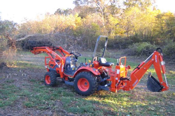

As Messick has pointed out, for the work you have described, you don't need to go with a fixed TLB but could use any number of tractors plus FEL plus BH combos to acheive the same end. I suspect the "true" TLBs are best for full time construction work but that doesn't seem to be your intended use. I am very happy with a small tractor based "TLB" and I paid a lot less than any of the models you are looking at. Photo attached.

I guess I am having trouble understanding the extent of the work you are planning. You have 5 acres. If it needs to be done all at once it would make more sense to hire in a professional crew to do it. If you have time, then it still seems to me that a smaller than 40hp tractor based TLB could do the job. Lots of guys are doing the type of thing you are with 30hp and lower tractor TLBs. There are a number of set ups costing in the 20-25K range from Kubota, Kioti, JD, MF etc that could do the trick. Add a grapple set up and brush hog and arguably you would work even faster than with a dedicated TLB. You don't need a 40hp TLB to dig out a few 24 inch stumps. I can do it with my 20hp tractor/bh. I have created 40ft brush piles too(wouldn't want to move them without a grapple though).
